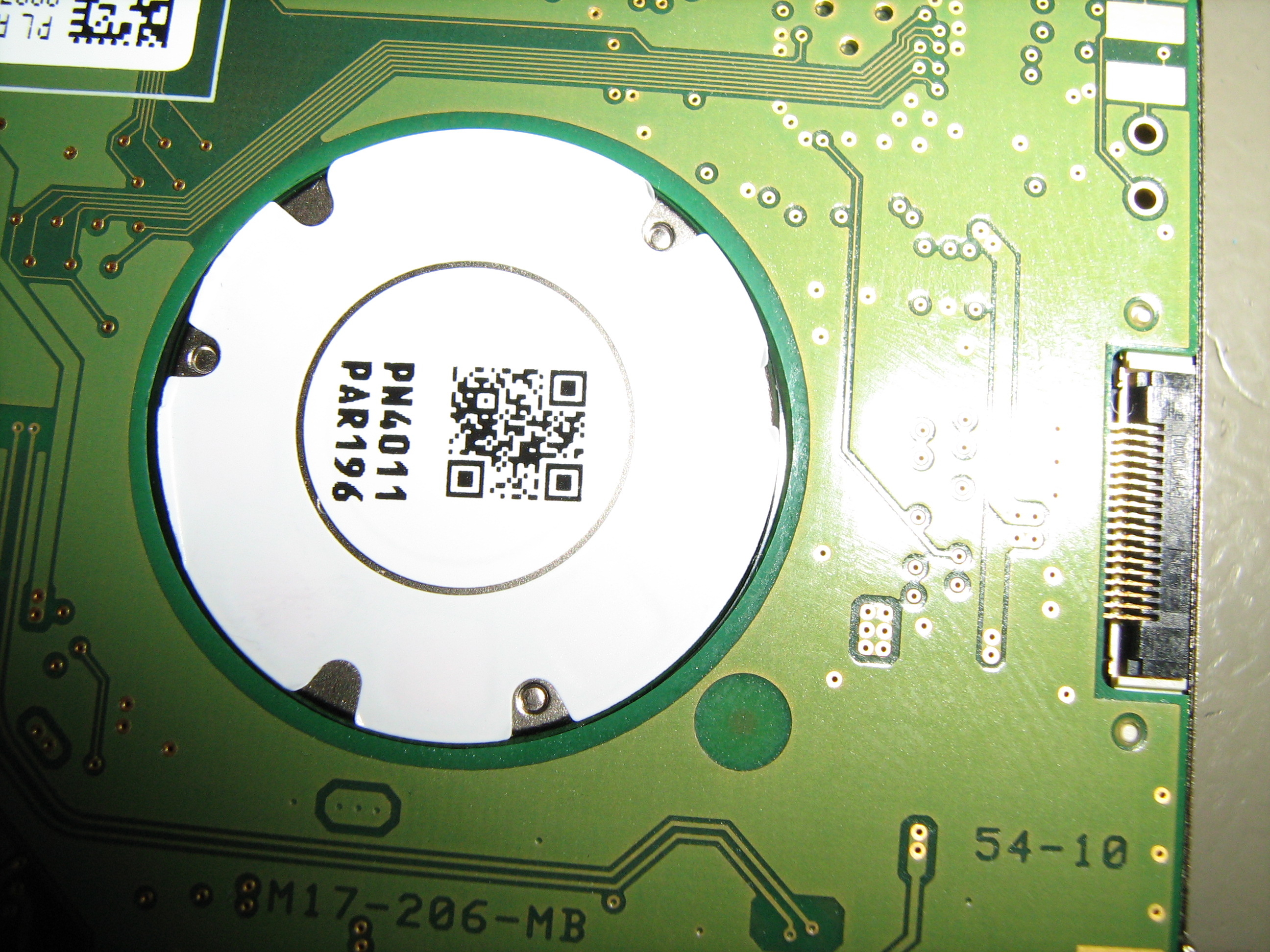

Should have been more specific.
I need to find a supply of 1.8" CE-ATA ZIF (CE-ATA) connectors. For specs goto http://www.ce-ata.org/specifications.asp
I'm not looking for CF+ 1.8" ZIF which was kindly linked to
I have also attached a picture if you cannot understand my cosmos speech ;o)

Does anyone know what this is? I guess know one has a scobby do!
 Post subject: Re: CE-ATA Adapter
PostPosted: January 18th, 2009, 11:39
Posts: 3598
Location: Chicago
This is ZIF connector
it has different type for different drives (but some drives have similar connector, like Toshiba and Hitachi)
I know two types of ZIF connectors and I have both adapters, just google it and you will find what you are looking for
PS: it might be also regular CF pin-connector (like on 1" drives) but it is hard to see from your picture. If so you would need third type of adapter

Ok know one knows....
I will keep searching. I have all of the other adapters and converters. As this is a new interface spec I guess it will take time before a suitable product is ready :O(

Still wrong connector :O) The CE_ATA uses MMC electrical schema, it's not ATA interface (PATA/PATA)

I'm also looking for the same adapter now (the small zif type). Any luck finding one? It seems others here don't really understand the difference, the adapter you need uses a smaller cable than a standard ZIF connector.

i am holding in my hand the same HDD in the picture, it is from my 160GB ipod. the connector inside was it a ribbon cable converting the ce-ata to a standard ZIF HDD interface. because of the largesize i am worried the controler inside will not recognize the drive.
