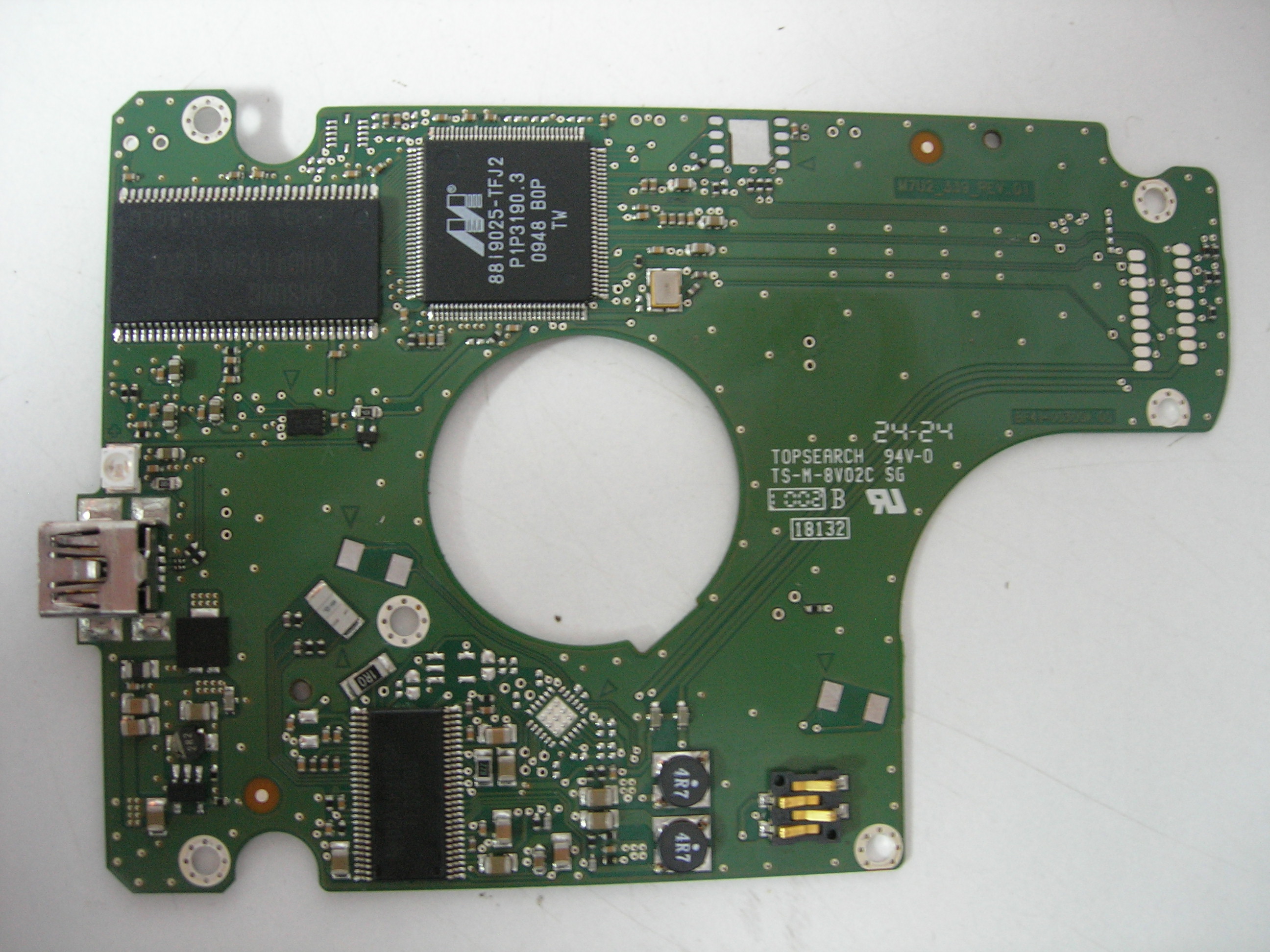

A straight board swap will not work. Each board has unique, drive specific information that needs to be transferred to the donor PCB. If you upload a detailed photo of the component side of the PCB, someone will identify the chip for you.

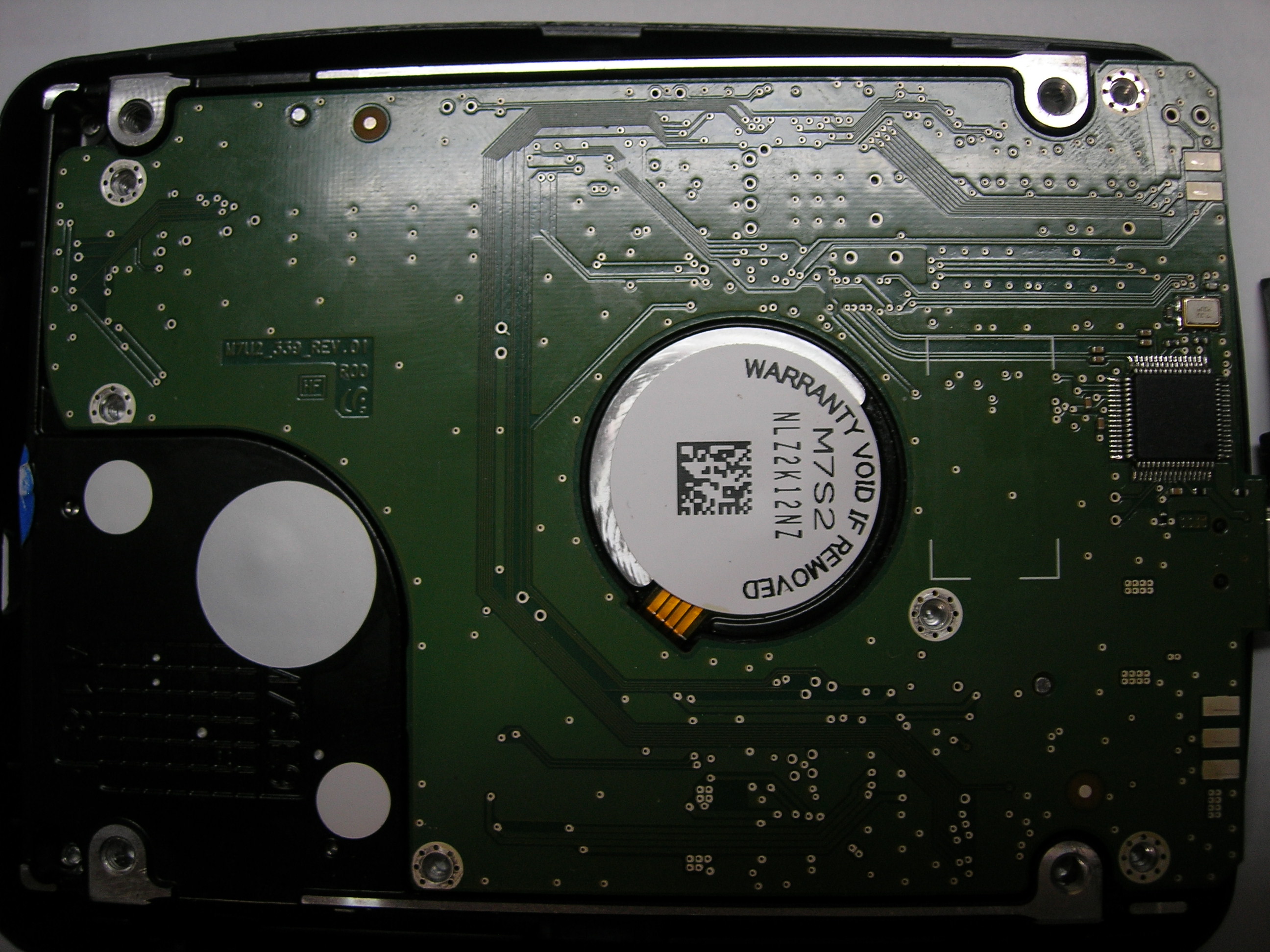

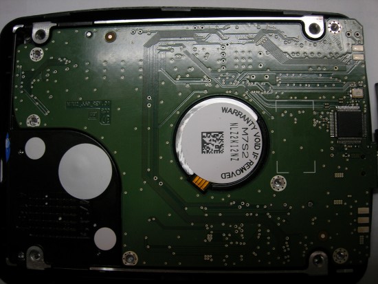

It not a logical issue (not yet) no electrical power suply is reaching the motor. So I can not read anything.
This is beacouse of I woult like switch to another PCB. ( from a currenly running disk with exactly the same model , size, weight, geometry )
I dont understant what king of specific infomation has every board ,¿ is not made in the same production line ? ¿ Is not exactly the same disk , heigth,size,geometry ?

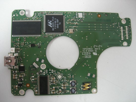

I have identified all the main integrated circuit.
a) 88i9025 -TFJ2 (P1P3190.3) 0948 B0P TW
b) SAMSUNG 004 K4H64 1638N-LCCC
c) Texas Instruments : 02A1HXTS TLS2505
And these are the pictures from the PCB

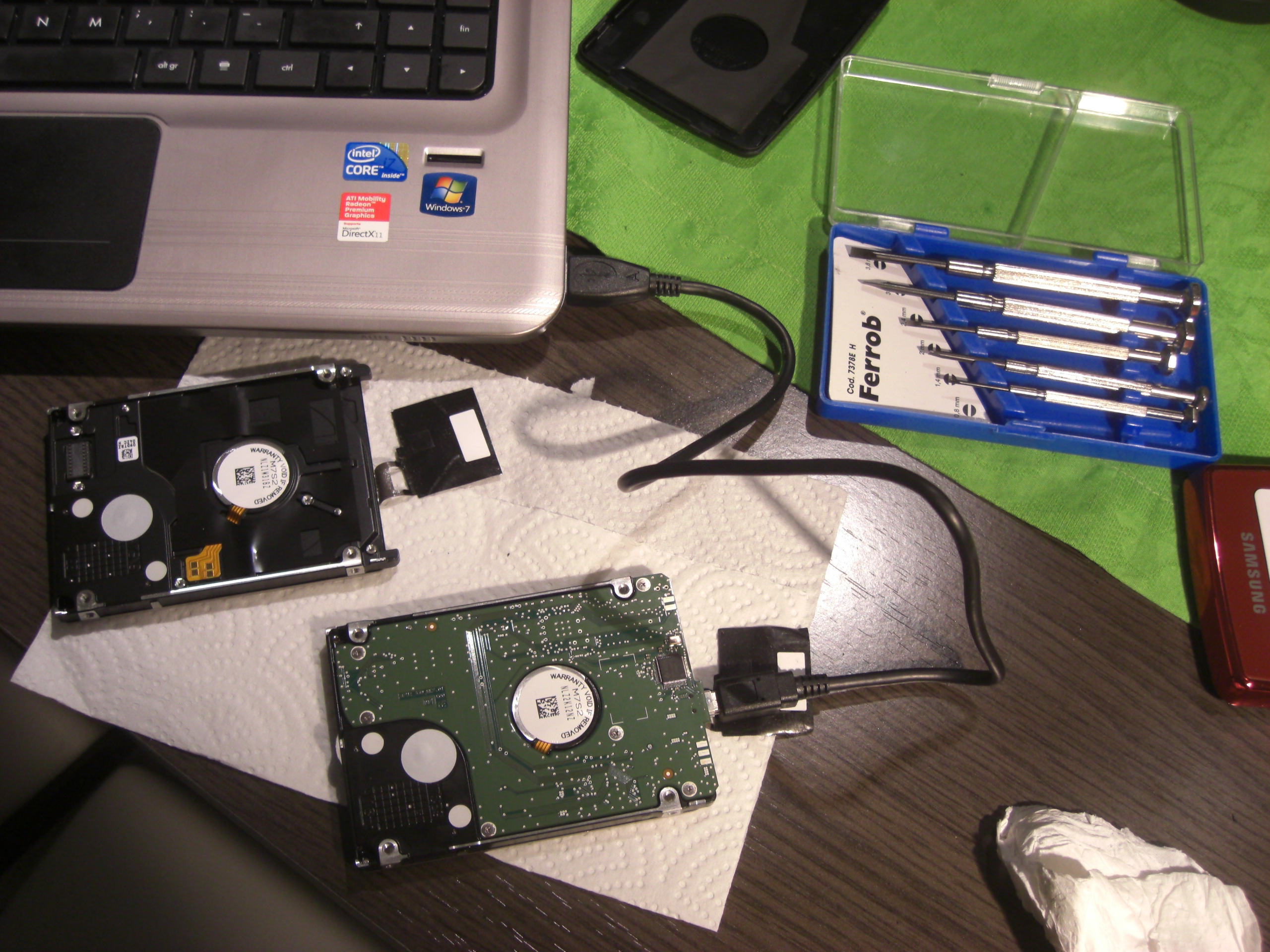

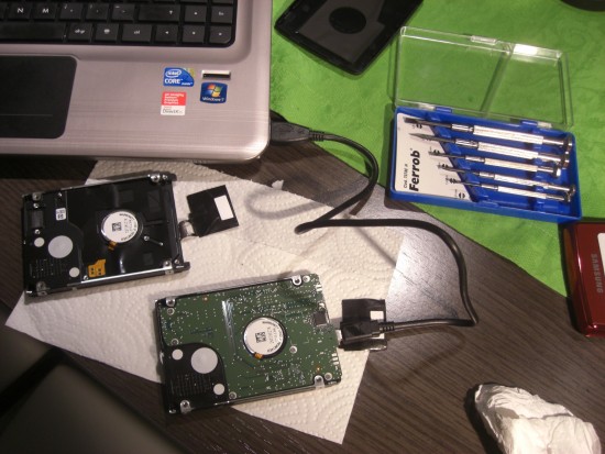

I'M JUST RECOVERING DATA!!!!!
I have access to the disk by swap de PCB from the other new disk (exactly the same . Now I'm doing a copy...
I have saved 650 € / 800 € that some data recovery enterprises intend to ask me for doing this work.
I'm really happy!!!
LOTS OF THANKS TO EVERYBODY.

So let me get this straight. You swapped the boards around and recovered your data. What was with all the other posts? Seems pretty straight forward. From my experiences, Samsungs aren't nearly as keen on adaptives as other brands so I'm not surprised it worked since you matched them up virtually identical.
You just made it out to be like you just created a time machine or something :)
In any case, congrats on getting your data back!
