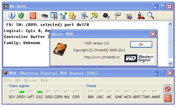

I heard WDR-UDMA is update to windows version!
File comment: WDR
STR3000,WDR,SRT,MRT

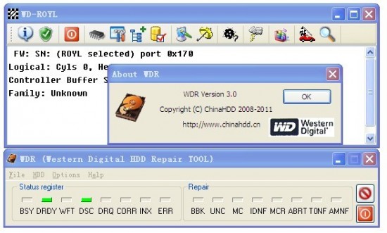

First chinese modified TREX to work with LPT dongle and they named it WDR ver 2.0 .
The newer version of WDR is the windows version picture is provided by huangensen.
Hey, actually i have the WDR-UDMA version 3.0 that works in windows with USB dongle, thats the one that we were talking about... the pack also came with WDR soft that works on MS-DOS and has the LPT dongle like you said, but i did'n use it yet
