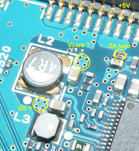

If it's not spinning, then it could be a PCB fault. You could try a PCB swap and firmware transfer.
http://ep.yimg.com/ay/yhst-144375849714 ... -fw-17.gif
Check the fuse near the SATA power connector.

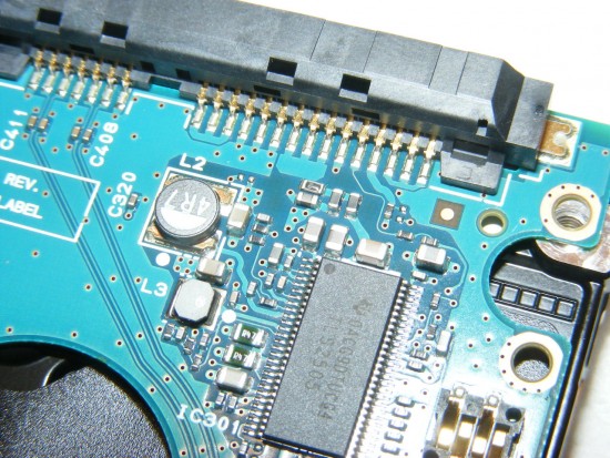

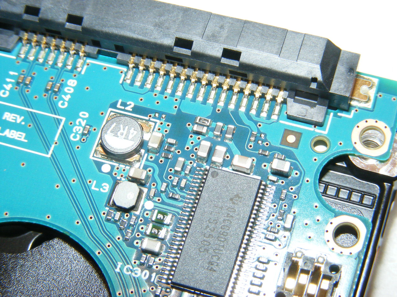

Okay, I'll be honest, I'm not sure which component there is going to be a fuse. Best I can see there's a 0603 0R link, which I've checked but it's all good.

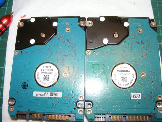

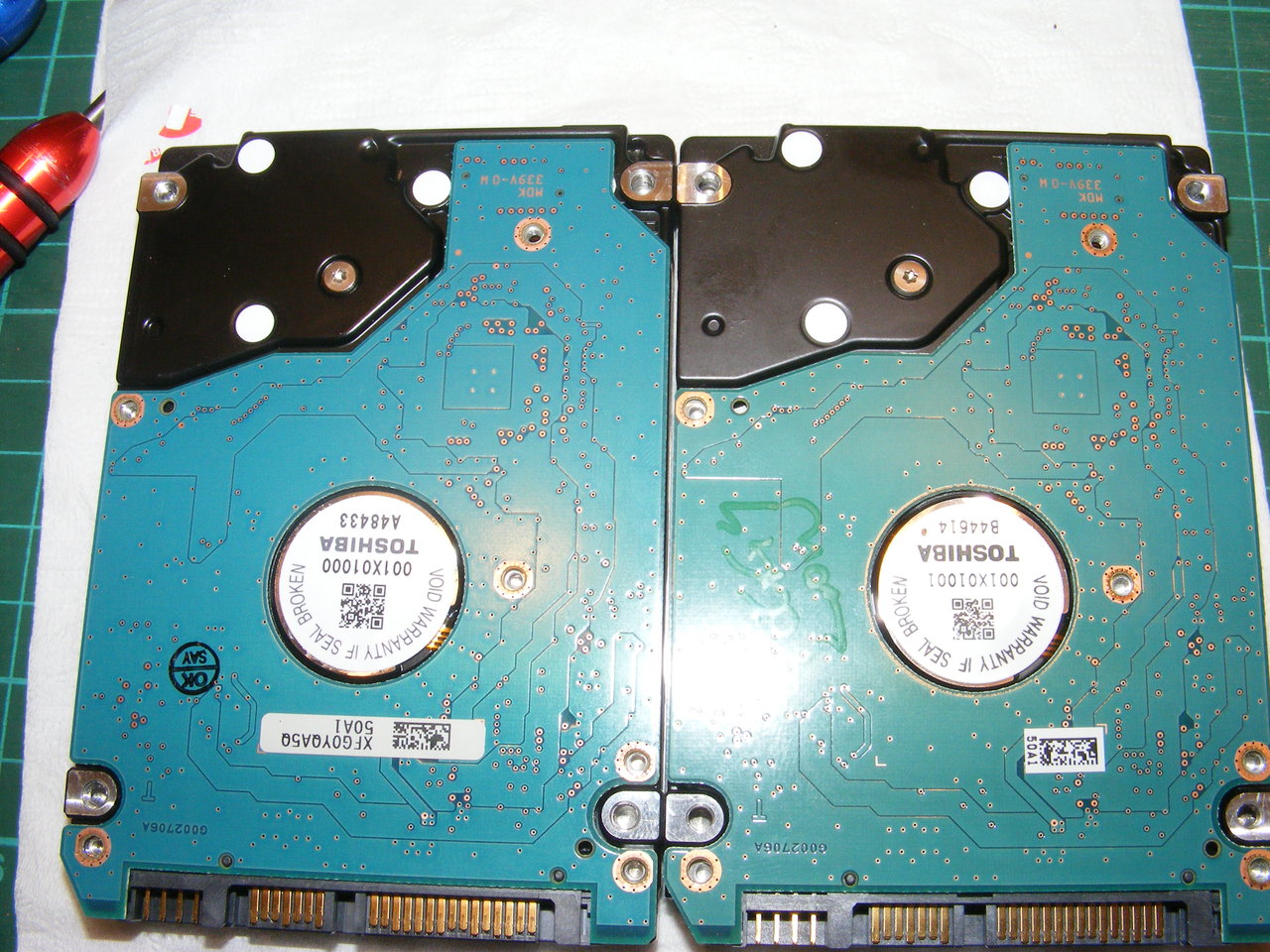

Astoundingly, the first drive on my stack of surplus drives was a PCB match for this one!
That said, I'd still be fine to send it off to be repaired instead. While I deal with SMD all the time, I'd feel kind of "safer" handing it off to someone who does HDD's for a living.
File comment: Power / switchmode region of the controller board. Tested the large E1 block (9.5K seems right) and the 0603 0R link closest to the SATA power pins.

File comment: Client drive on left, "spare" drive on right (has slow-read issues, suspect failing amp/head).

Here are the voltage test points:
Vcore 1.18V
Vio 2.50V

inflex wrote:
Vcore 1.18V
Vio 2.50V
Those look OK.

Additionally, better to check voltage on the motor during power on. If it's OK, so sold off ROM IC and read/check it's content. Sometime, it's damaged (for example, zeroed at the whole content address range).
Have you tried changing the PCB as the Donor drive seen in photo is a PCB Match for your Patient.
If it still does not SPIN it there could be great chances of "Head stiction" as these drives do have this issue.
