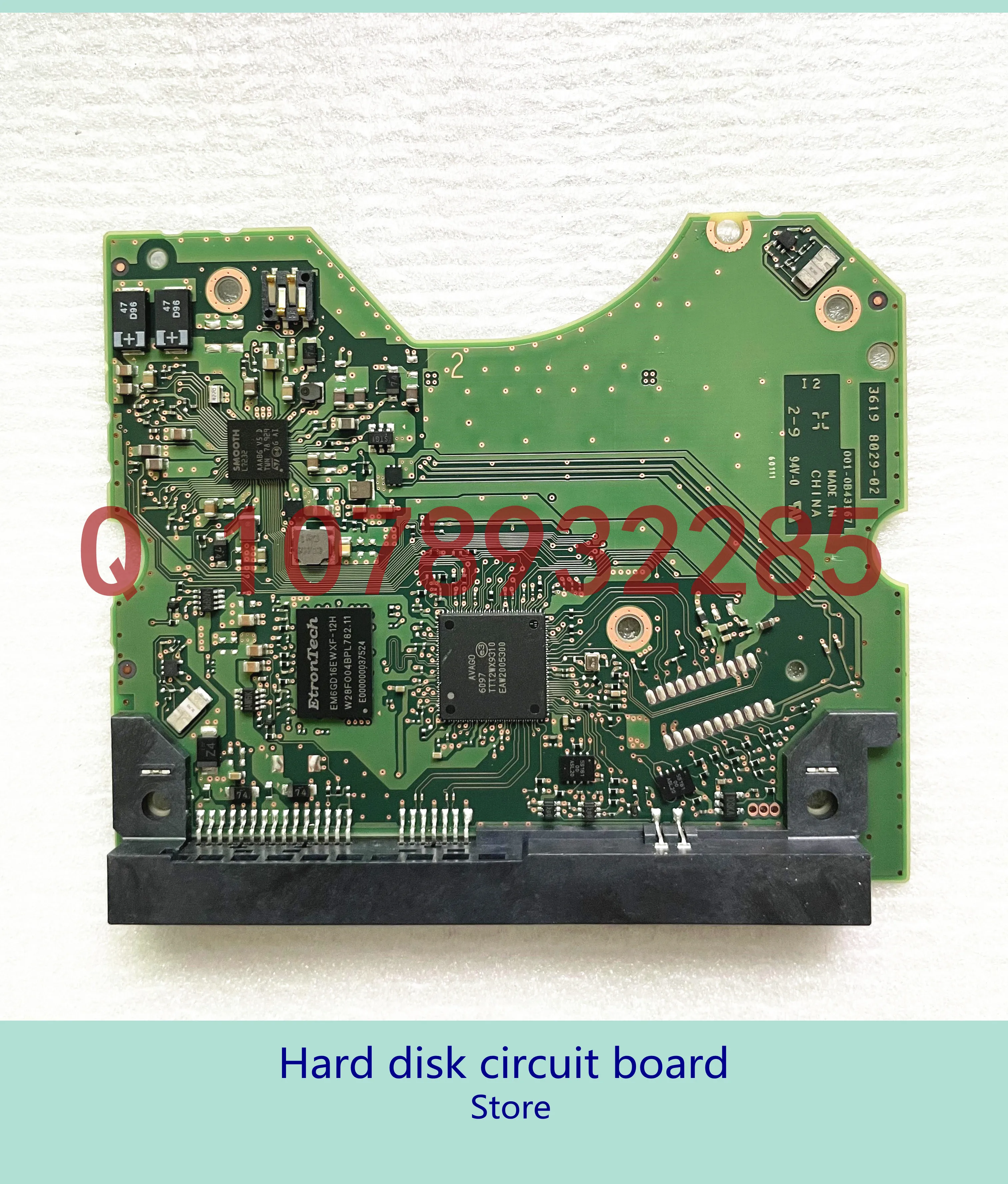

The PCB number is 004-0B43167 and the dirve is a WD101EFAX WD RED 10TB PLUS, any info is greatly appreciated, thank you in advanced JR.

I can help you repair the PCB if you upload detailed photos. This PCB has two stages of protection -- smt fuse, TVS diode and e-fuse. There is one set for the 5V rail and a second set for the 12V rail.
https://ae01.alicdn.com/kf/H79771994e51c4c379ed54dff2d6b2e69Q/0B43167-Hitachi-IBM-Western-Digital-Enterprise-Hard-Disk-Circuit-Board-004-0B43167-001-0B43167-0B43166.jpg

Thank you for the information, My main concern with the PCB is that I swapped the board on my unit with a donor I purchased on ebay.
I want to be sure I swapped the bios / memory chip correctly.
This board seems to have two chips, from the littleb bit of infomation I found online, it recommended to swap both chips. After swapping the PCB, I am now getting the machine to recognize the drive, however when i try to initiate the drive I get an error:
