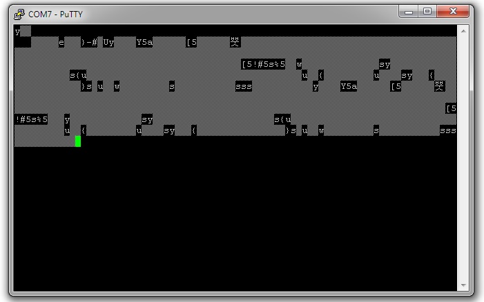

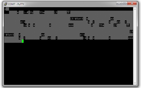

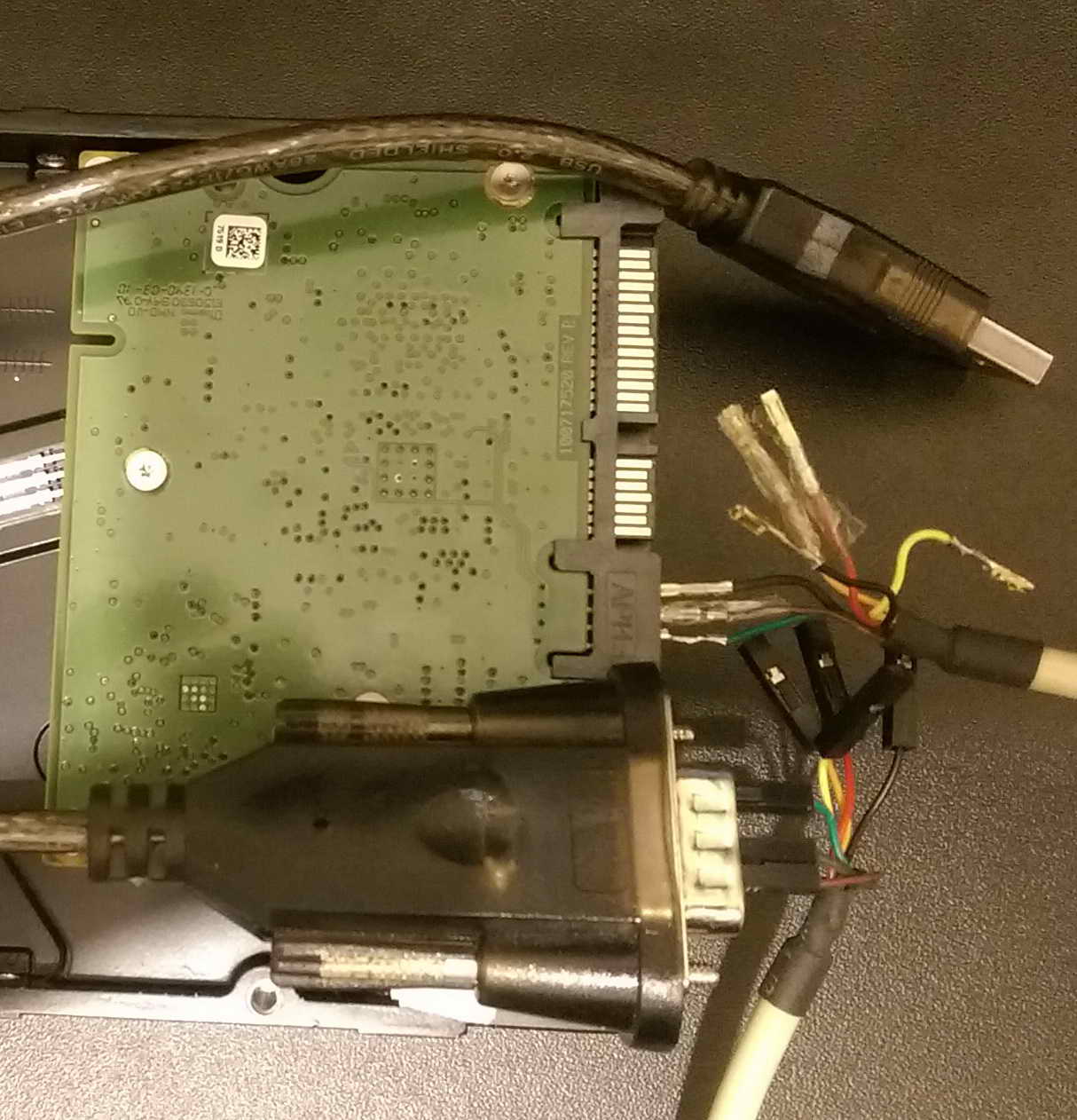

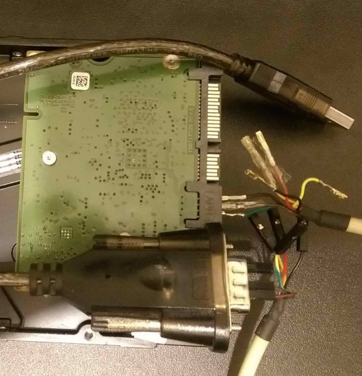

I started the terminal using putty, and I receiving as you can see in the pictures, a nonsense output.
I don't know if the cables or because I don't use a proper TTL-USB adaptor could be the problem.
 Post subject: Re: Seagate Barracuda ST2000DM001 1CH164-510 fw cc27 problem
PostPosted: August 3rd, 2016, 17:35
Posts: 17226
Select a baud rate of 38400 bps.

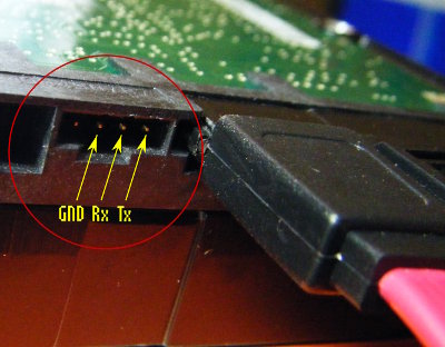

Have you followed the correct pinout?
http://www.kepmegosztas.com/img/b2e415fdc539c3e16732a0a5c4e24288/seagateconnector_pinout.jpg

I may be wrong, but from the picture, the cable you have isn´t a USB-> RS232 cable, that is, one for "creating" a serial port in a computer without one ?
If that is the case, you should not connect the hdd direct to that cable, but would need another adapter to do the conversion from TTL<->RS232 ( a MAX3232 kind of circuit )
