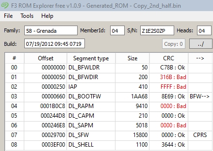

PS: That is the rom I composed with like 20 dumps. Want me to send ALL dumps? :roll:
Thing is when I click on READ, it gives me pieces of the rom... I don-t know how to explain it.

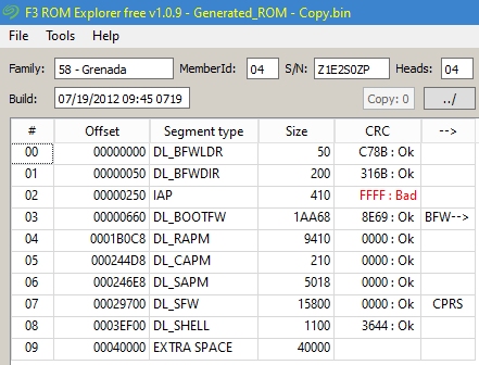

The first half of the ROM looks OK, according to F3RomExplorer. However, the second half is a corrupt copy of the first half. F3RomExplorer refers to this second half as "extra space", so I'm wondering why. Maybe you should patch the ROM so that offsets 0x40000 - 0x7FFFF are identical to 0x00000 - 0x3FFFF?
F3RomExplorer:
http://www.hddoracle.com/viewtopic.php?f=22&t=2534
Don't worry about the bad CRC for the IAP. That's normal.

This is how F3RomExplorer parses the second half of the ROM:
I have attached the modified ROM (with identical halves).

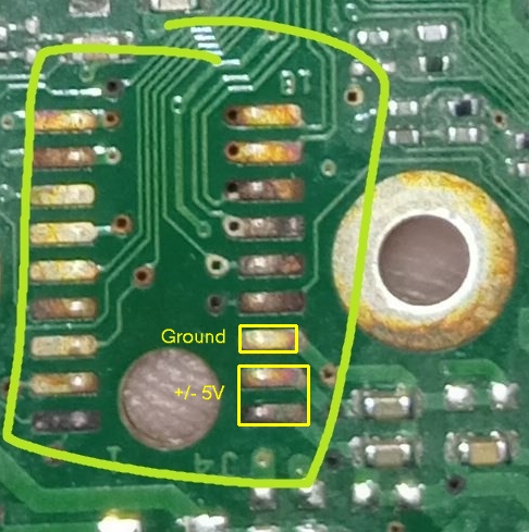

I think the OP needs you to identify the J4 pads.

Here is my guess as to the preamp supply test points:
Do I have to test it with the pcb off the drive? With no supply?
Anyway the PCB is a good one, and I tested it on another hdd and it works fine.

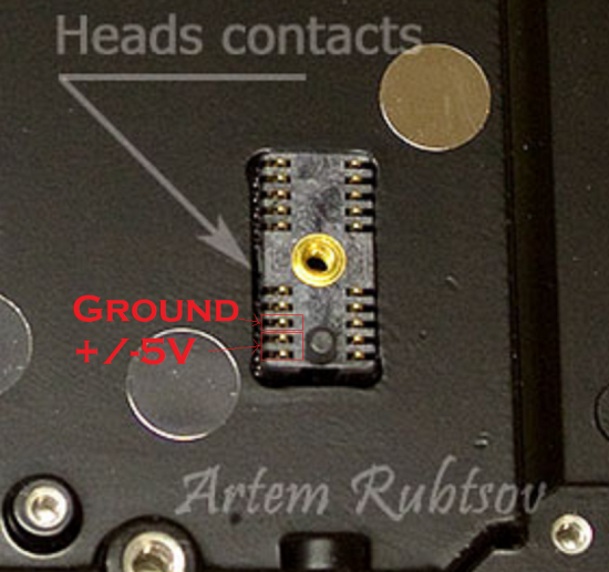

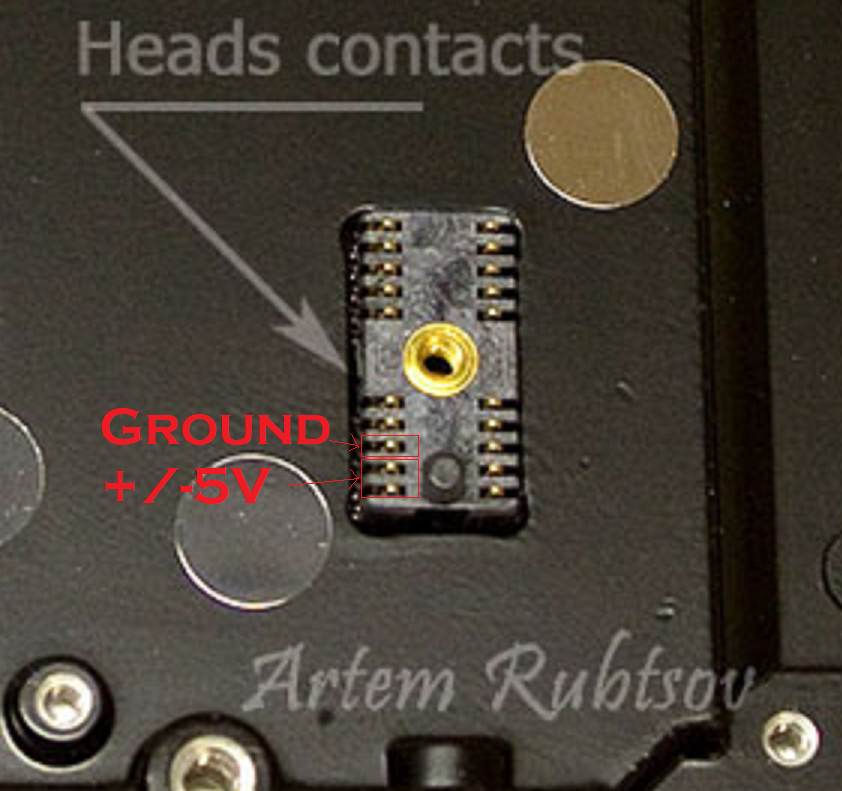

You need to identify the corresponding pins on the HDA (head/disc assembly). Then measure the resistance between ground and each of the +5V and -5V pins. No need to power anything up.
https://hddscan.com/doc/images/hdd_main_parts/HDA1.jpg (heads contacts)
The preamp is inside the drive, not on the PCB.
https://hddscan.com/doc/images/hdd_main_parts/preamp.jpg
https://hddscan.com/doc/HDD_from_inside.html
