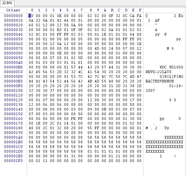

PostPosted: June 20th, 2012, 11:17
Joined: June 20th, 2012, 10:27
Posts: 5
Location: help me with my password
I dont know what is my password. :shock:

PostPosted: June 20th, 2012, 11:27
Joined: July 7th, 2010, 4:45
Posts: 924
Re-read & follow my post.
Your inputting a WD master password ie the WDCWDC bit without the ""
If you cant do this then you need to seek a pro.

I have WD5000AVDS and I have a problem with master password. I have tried unlocking with WDCWDC... and others similar.
I have tried using MHDD with two scripts for WD and WD Marvel. HDD was pluged either on SATA and SATA-IDE adapter. I have tested MHDD with scripts on three different PCs (gigabyte-k8ne, MSI-P45Neo and some old ECS-k7vta3).
I have successfuly test this one script and gets two .bin file.

PostPosted: June 23rd, 2012, 12:53
Joined: June 23rd, 2012, 9:41
Location: poland
I don't see any option to edit my previous post.
I pluged HDD WD5000AVDS-63U7B1 (FW: 01.00A01) by SATA-IDE adapter to IDE1 as primary channel.
zu /p
ERR:51A00000434404 CMD:5744430000A08A
ERR:51A00000B40F04 CMD:D601BE4FC2A0B0
mavr_r 00
Module Id:FFH Len=0000H Sectors Status=040FB4-51-51

PostPosted: June 25th, 2012, 5:28
Location: poland
Success, I finally did it! :-)
The third version of ZU worked for me (zu.betta.050911), almost gave up. It was a nice surprise to see "UNLOCK DONE".
MHDD shows that the password is off. Then I had a problem with formating drive in Windows disk management and other partition tools but MHDD coped with this (I've used commands CLRMBR and FDISK) and now i can use WD5000AVDS in my PC :-)
Thanks for this thread. I still wonder what was the default password used by this PVR because WDC.. didn't worked.
Have a nice day everyone :-)

Hello Gurus, I am stumped and having the same problem as quoted below. The drive is a WD1000BEVS that was in a Gateway laptop that has died, so I have the drive hooked up to another PC (via SATA cable, set to IDE compatibility mode). Password was set at BIOS level and I already knew the password ("debbie55"), but I ran the MHDD script anyways just to confirm, and what what little knowledge I have from reading this thread, it looks like that's right (except it's padded with 00's). MHDD/HDAT2/Victoria show the security level as "High". I want to avoid a "destructive unlock" since I actually need the data on this drive. The master password revision code is FFFEh.
I've tried converting to decimal and then holding alt-gr and typing it out, and it does type out the password, but the unlocks still fails. If there is another way of entering the PW or sending the PW to the drive (Victoria for Windows?) I am unsure how to do it and would appreciate any help. It looks like the user 'subspace3' got the same problem resolved but did not post how :/ I know I'm probably missing something obvious...
Attached is my 22.bin

HDD: WDC WD3200BEVT-75ZCT2
Thanks for any help!
