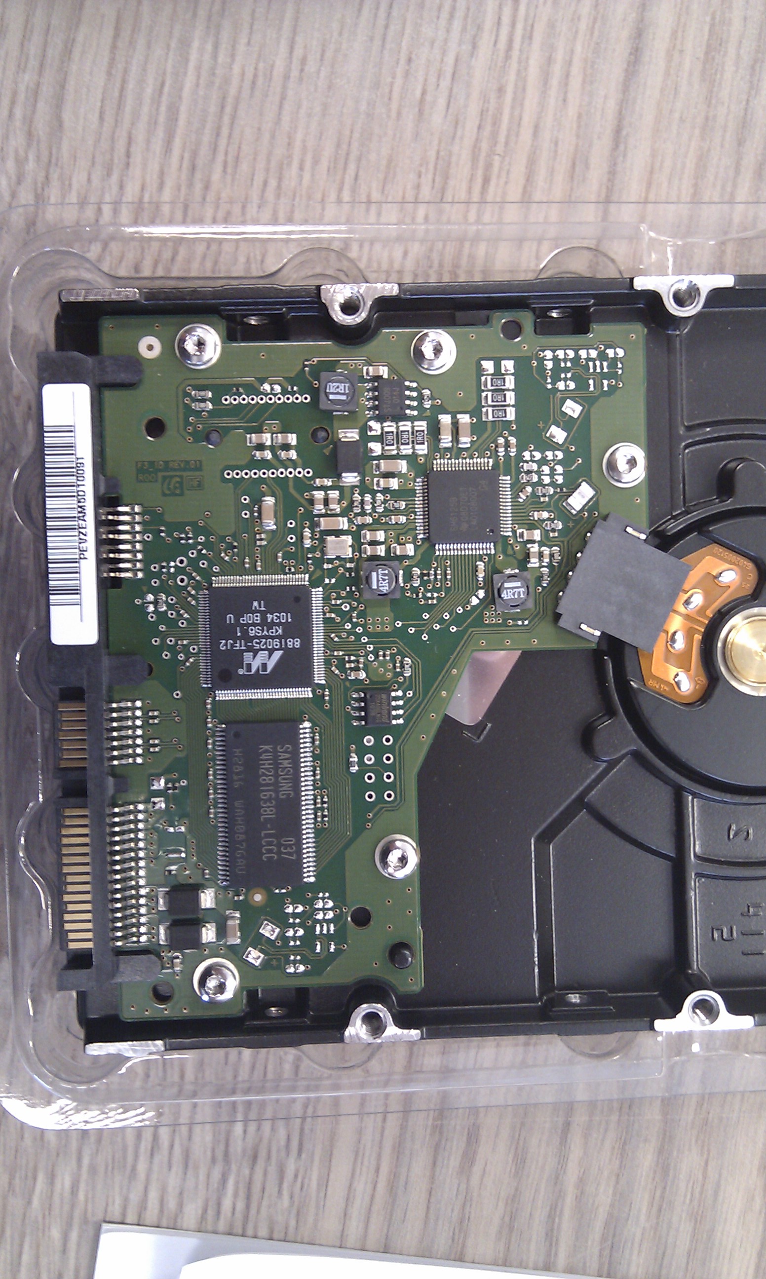

Location: Holland
got a 500W PSU, and a ATI 4830 Overclocked and AMD Phenom x4 9650, so i don't think PSU is too big.
BTW i got mail back from webshop, don't think this PCB will work on my HDD, what do you think???
It's a Rev 01 R00 PCB, mine is Rev 02 R00. I see different MCU i guess.
 Post subject: Re: Samsung hd502hj
PostPosted: January 21st, 2011, 10:15
Joined: June 30th, 2009, 16:06
Posts: 60
Location: Germany
Fact is, your PSU and / or hdd internal voltage transformers generated voltage spikes, because a TVS will NEVER die without overvoltage. You can measure that with an oscilloscope, to be sure.
To the PCB: Please try it, or buy a 100% fitting PCB. eBay is a good source.

_TK_ wrote:
....because a TVS will NEVER die without overvoltage.
Yes i Understand, PSU is being replaced, i also had an other 500W PSU.
I think i'll wait with the PCB shown on picture, just to be sure. I'm looking if i can find something closer to match.

hmm, can't seem to find an F3_1D rev 02 PCB in Holland.
all my returning emails from shops are rev 01.
guess it's time for reverse engineering my pcb

Yes, i found an donor HDD, with PCB F3_1D rev 02.
So it's the same, do i HAVE to swap U12 serial flash ROM or can i try it first without swapping??? Or will it do more damage???
It's not that i can't remove the ROM, it's more simple without doing it.

the question was: If i don't swap the ROM can it damage other component of my drive????
read something about data being written to NVRAM and you end up with two dead drives.
That's all i needed to know.

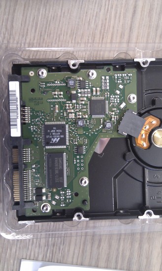

another question, any chance of successful PCB swap?
dead drive: HD502HJ
PCB: F3_1D rev.02
Sata connector sticker: PEFZE1A5D21696
PR. Date: 01-2010
Donor drive: HD502HJ
PCB: F3_1D rev.02
Sata connector sticker: PMM3EC58B22971
PR.Date: 12-2010
PostPosted: February 25th, 2011, 12:03
Joined: January 12th, 2011, 14:48
Posts: 45
Location: Holland
so i got my donor drive in and swapped pcb's.
Dead drive spins up now but bios doesn't go any further.
donor drive with old pcb, doesn't work, no spin up nothing.
so i think there's something with my pcb, haven't swapped serial flash rom BTW.
Maybe next step???
