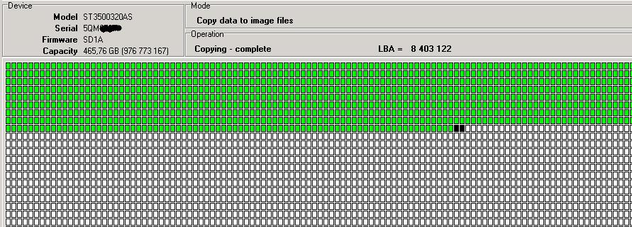

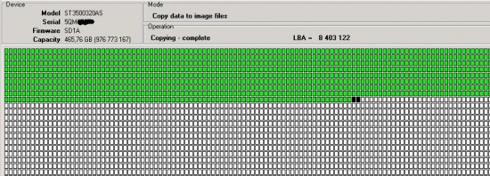

Hi to all hddgurs,
Have this disk with the LED problem.
Fix that, with the udma, now i can have ID, DRD DSC.
But this case when i start copy (green) i just could copy 6 400 xxx sectors.
The rest it give error,
If i change to read with no CRC Control i can have some data but is not OK.
Anyone have this issue after resolving the LED problem ?
ZeBong

Have this in the UDMA

yes i have try this:
F3 T>m0,2,2,6,0,0,0,22
Max Wr Retries = 06, Max Rd Retries = 00, Max ECC T-Level = 00, Max Certify Rewrite Retries = 0000
User Partition Format Successful - Elapsed Time 0 mins 00 secs
But is the same.
I think that the problem is with the P-list.
Something happen when resolving the LED problem.
If you know any commands to regenerate the p-list PM me.
