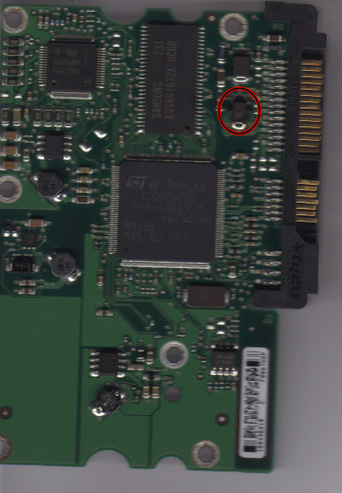

Seagate Barracuda 7200.10 320GB - ST3320820AS
I've got a dead hard drive ("vibrates", then gives a short beep, this is continuous) to which I bought a donor drive for, so that I can swap PCB's/exchange platters if required. On the dead drive I however have a broken SATA connector and so it is really difficult to plug in the SATA data cable. Recently I have however by mistake put the cable in reverse and that caused smoke to come out of a small square electronic (probably a TVS) instantly. I immediately unplugged it from both the motherboard and computer PSU. I haven't got a multimeter to hand yet and I haven't tried plugging the hard drive back in. Would you suggest to simply do a PCB swap, that actually might bring the data back? Or shall I remove the TVS and try to set up a serial connection to diagnose the hard drive.

When u say the drive vibrates, do u meen u can feel the platters inside the drive spin? The beeping u had before reversing the power and blowing PCB sounds like seized platters. Oh , and a small square chip is probably voice coil controler, not a diode.

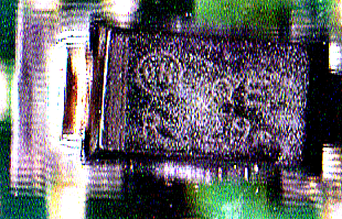

I'm not sure if they actually spin, but it seems more like they try to spin. Could that be a seized motor? Oh and actually its not a square shape, its a rectangular shape. Here are some pictures.
I have with a high resolution scan (1200 dpi) and Photoshop tried to make the writing on that chip readable. It says: QE R729

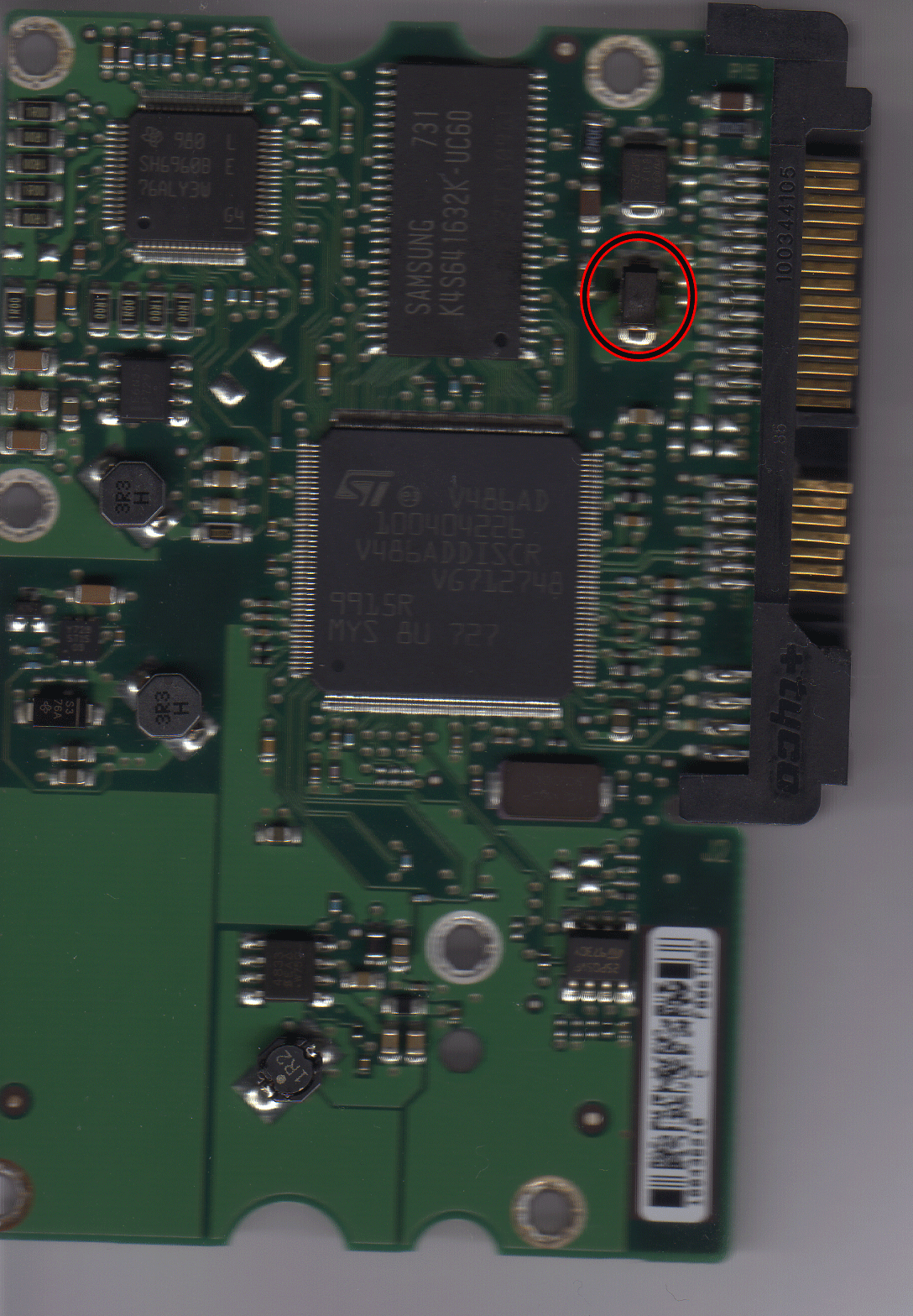

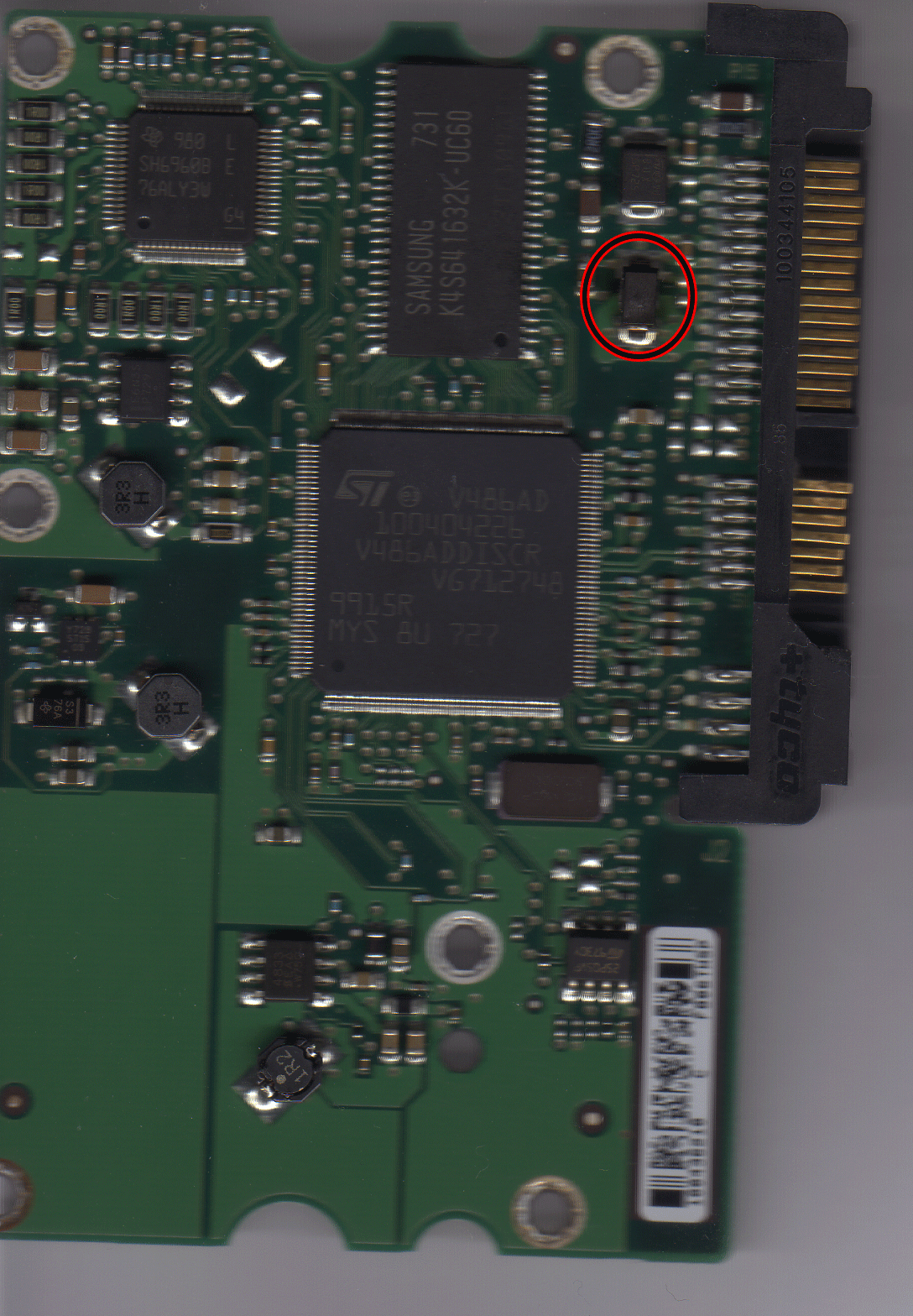

I'm not sure if they actually spin, but it seems like its trying to spin rather than actually spinning. Could that be a seized motor? Oh and the chip is not actually a square shape, its a rectangular shape. I have attached some photos.
With a scanning resolution of 1200 dpi and some Photoshop I was able to read the text written on that chip it says:
QE
R729

The diodes will have marking codes, eg BUX or QE.
See my notes for help in identifying the components:
http://www.users.on.net/~fzabkar/HDD/TVS_diodes.txt
http://www.users.on.net/~fzabkar/HDD/HDD_ICs.txt

Thanks. I'll have a look at that then. Oh and the faulty diode clearly says QE R729 as can be seen on the picture.
 Post subject: Re: Broken SATA connector - Cable plugged in reverse - Smoke
PostPosted: August 19th, 2010, 10:32
Posts: 775
Location: Toronto
Yes, the circled chip on the picture is indeed a diode. If it did its job and no other components got spiked, , removing in should restore PCB into working condition. Now the tutorial you linked scares me half to death tbh. If u truly want to go ahead with it - best of luck to you, but chances are very very very very low. If the DIY is your ONLY option - then after restoring PCB to working condition, open the drive and look where the read write heads are. If the are sitting close to the metal circle in the middle - they are parked and its not sticktion.
