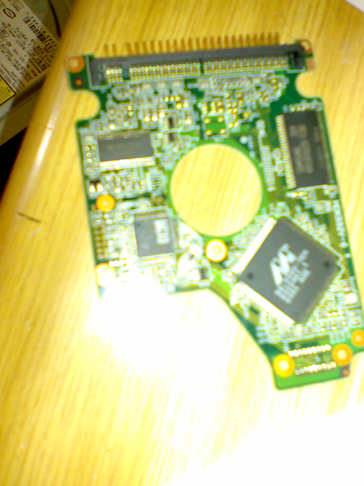

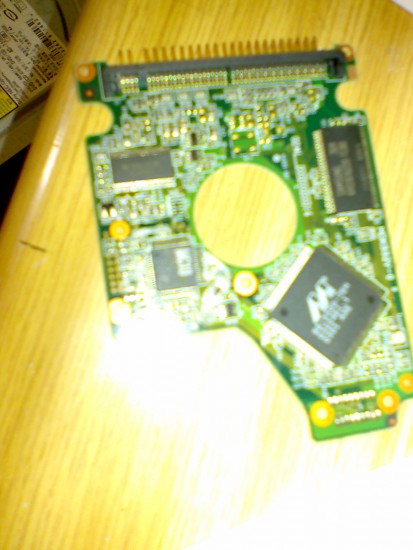

hi
i have DK23EB-40 which doesn't show up.
we have an identical drive.
i understood from this forum to transfer/echange Marvel chip or some other chips.
can anybody send me the location and which chips to transfer?
Ii am attaching a picture of the mbo.
thanks in advance
ephraim

 Post subject: Re: Please help with Hitachi DK23EB-40
PostPosted: October 1st, 2010, 18:58
Posts: 17384
Does the drive spin up?
BTW, the "adaptive" data appear to be in the Marvell MCU (big "M").
PostPosted: October 3rd, 2010, 18:54
Posts: 17384
If the drive spins up with the original PCB, then the problem is most likely not with the board. Otherwise, if it doesn't spin up with the original PCB, but spins up with the replacement, then the chip swap should work. However, you will have a hard time finding a shop that has the necessary smt rework equipment to do this job for you.
The following URLs should help you identify some of the other chips:
easy-faultdiagnostic-troubleshooting-must-try-t12319.html
http://hddscan.com/doc/HDD_from_inside.html
http://www.users.on.net/~fzabkar/HDD/HDD_ICs.txt
http://www.users.on.net/~fzabkar/HDD/TVS_diodes.txt
PostPosted: October 4th, 2010, 3:32
Posts: 17384
You need something like this:
http://www.google.com/images?q=%22smt+r ... 22+station
I don't have any schematics for your drive. If I were troubleshooting it, I would trace the DC-DC converter circuits, and use some basic electronic troubleshooting principles. That's why I directed you to the WD and Seagate URLs.
BTW, I'm not a data recovery professional. I'm only following Starling's advice.
That said, I'm wondering whether the smaller of the two square chips is an EPROM or flash memory. Can you tell us the part numbers on the 4 biggest chips? Your photo doesn't help at all. :-(
