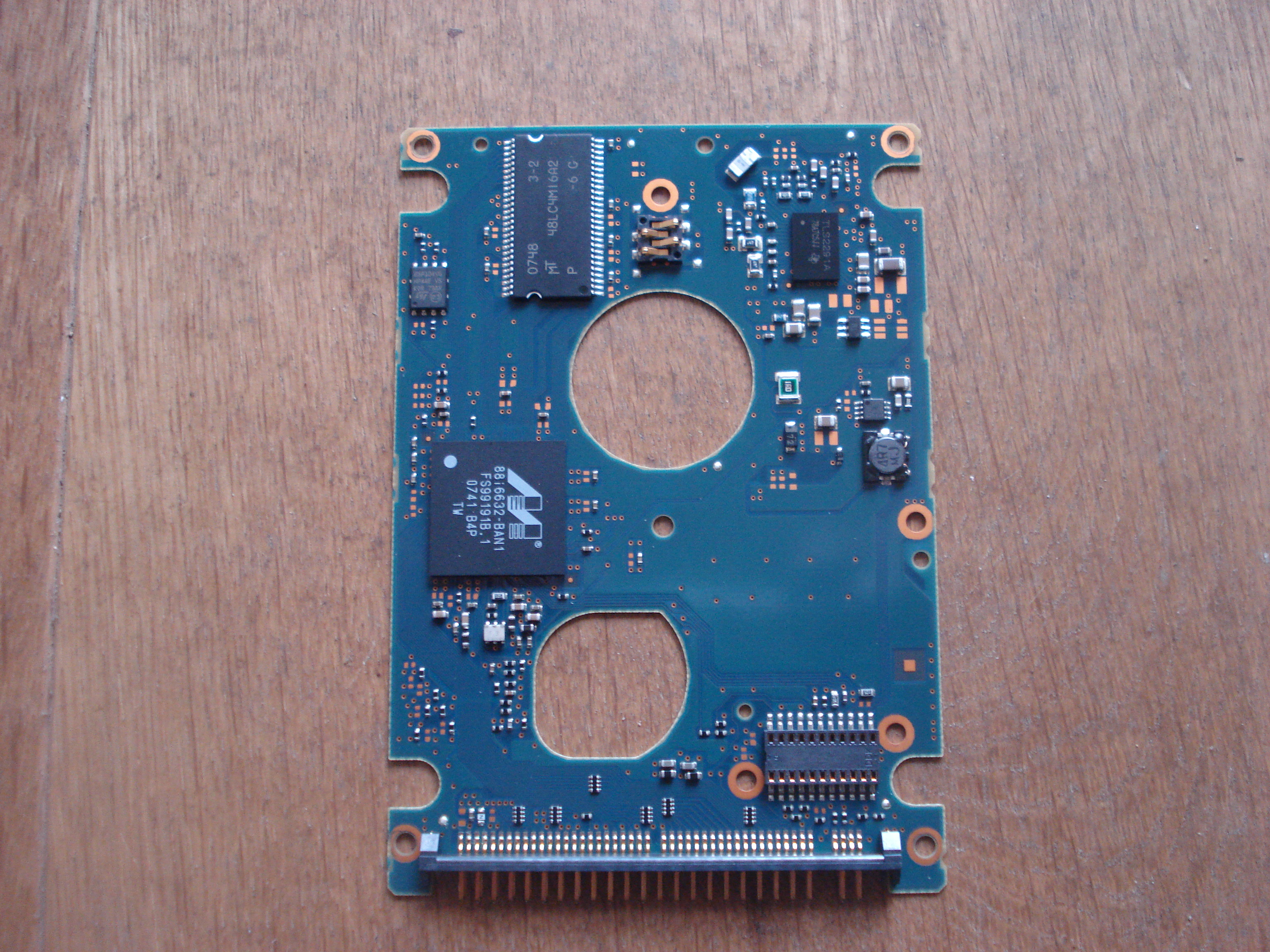

I have got an Fujitsu 120GB 2.5" IDE hard drive. Model Number: MHT2120AT. The hard drive 5 volts got connected to 12 Volts and an IC on the PCB has Blown. Does anyone know what the IC is and can I replace it?
The IC is next to the coil and is an 8 pin IC - I think it is an voltage regulator???
I have attach an image of the PCB
Also there is an short between the 5volts to GNd
thanks

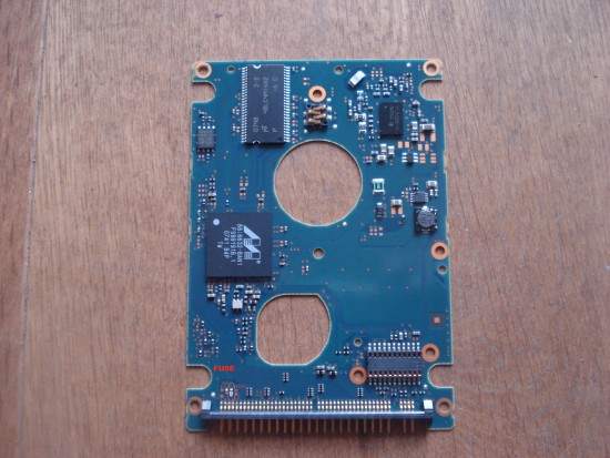

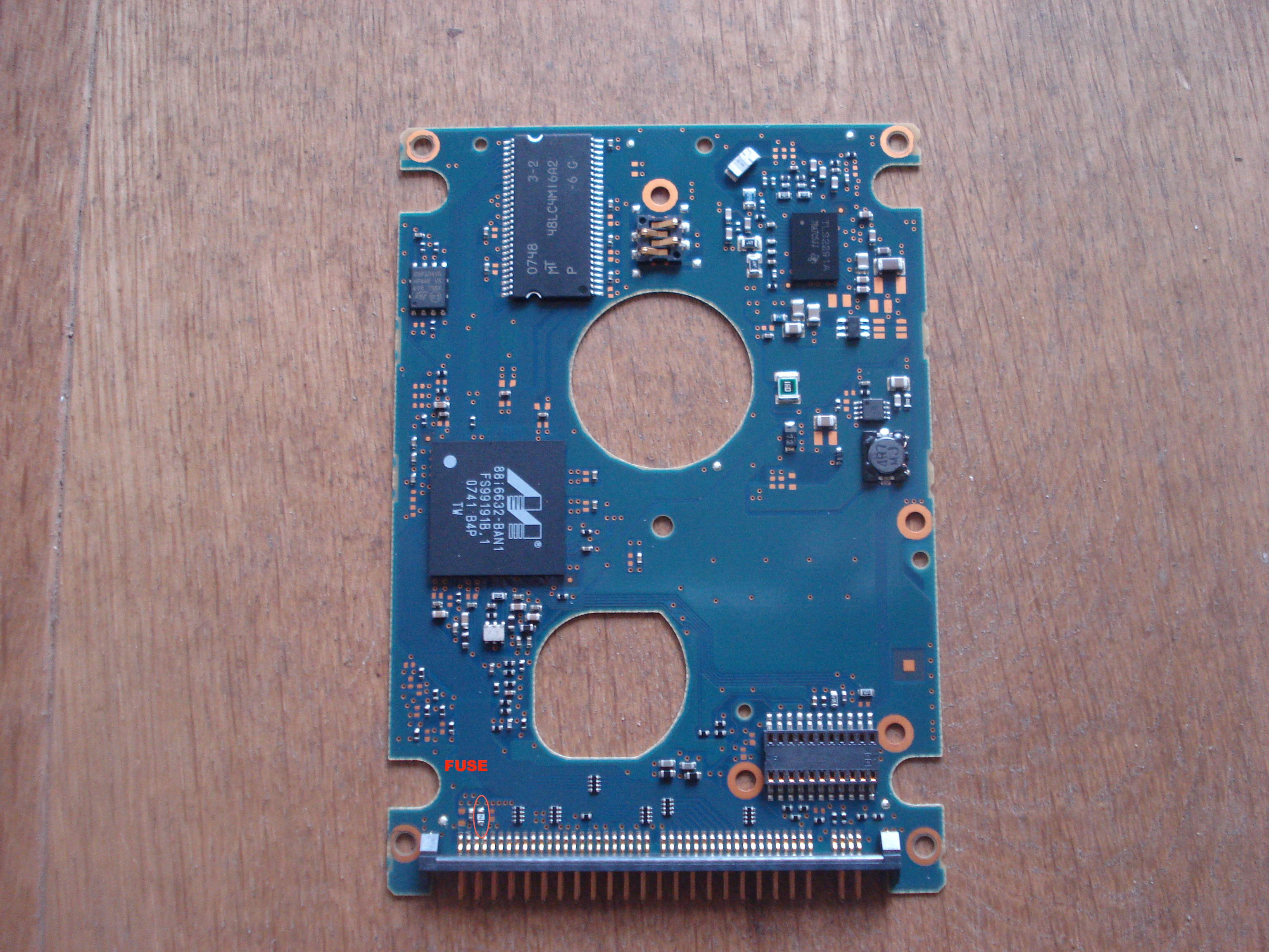

Try to check the fuse.
Bosse
[img]
[/img]

Hi
Thanks for the info.
The fuse is ok. I think the isue is the IC near the coil
does anyone know what the IC is and where I can get a replacement
