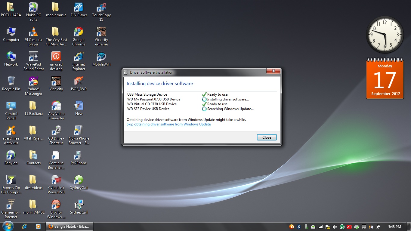

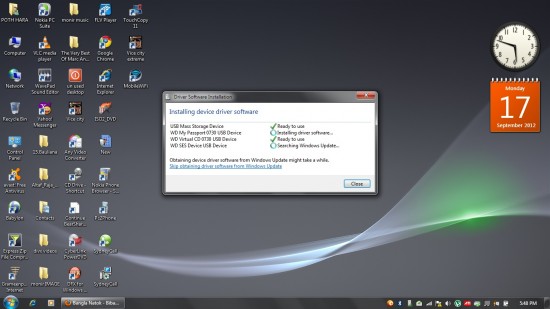

Hello everyone,

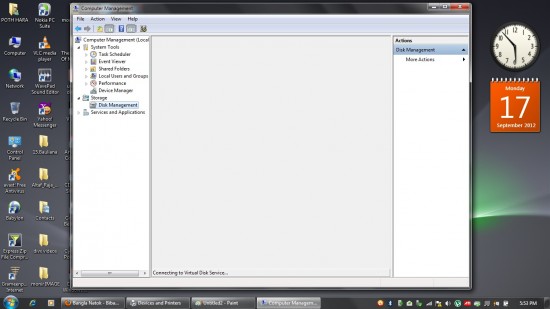

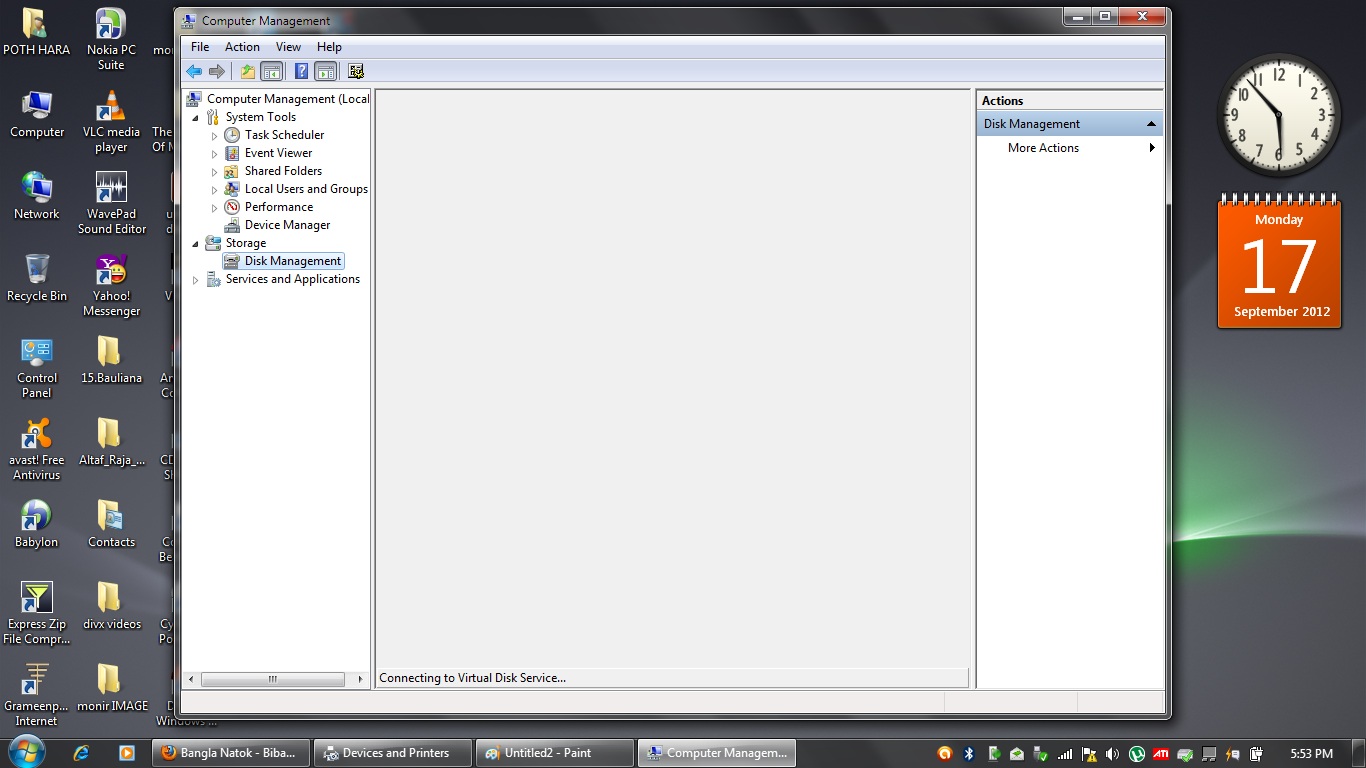

I have WD passport essential 500gb USB 3.0, When I plug the USB cable in my laptop even any pc the light comes on and Windows recognizes that the device is there, and says that it has installed the approapriate software for the device and it is ready to use meanwhile its searching driver to installing. after sometimes its showing in my computer as CD Drive (F:). Also, I have right-clicked on my computer and then the Manage option, and under Disk Management but this page is not opening only after disconnect the usb cable its showing disk drive page.
for your information i have attached some necessary screen shot... I just need some help on how to solve this problem.
thanks & best regards
File comment: when i try to open disk managment its showing in the bottom... connecting to Virtual disk services... and standby like this only but after disconnect the usb cable this page opening immediately.

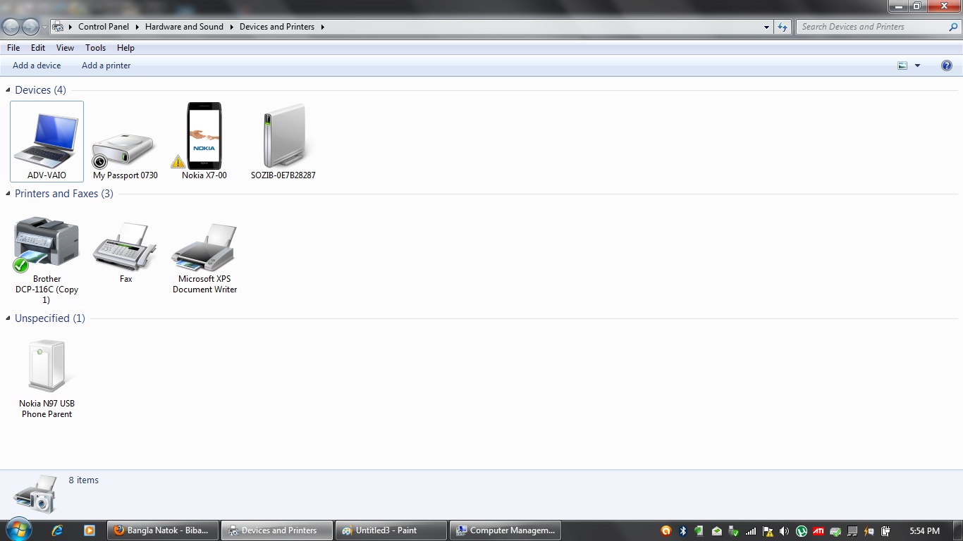

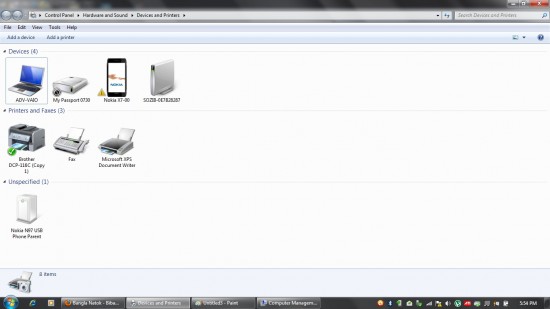

File comment: showing in control panel - device and printer
File comment: after plug in the cable

hi,
what kind of sounds do you hear when you plug in the disk?
the motor stay on or after a while spin down?

italian-recovery wrote:
hi,
When i plug in the disk there is sound of spin but after few second spin down and again same things happened 2-3 times then no sound at all, but the lights still on
hi,
Bad heads
Physical problem
No DIY :-(
