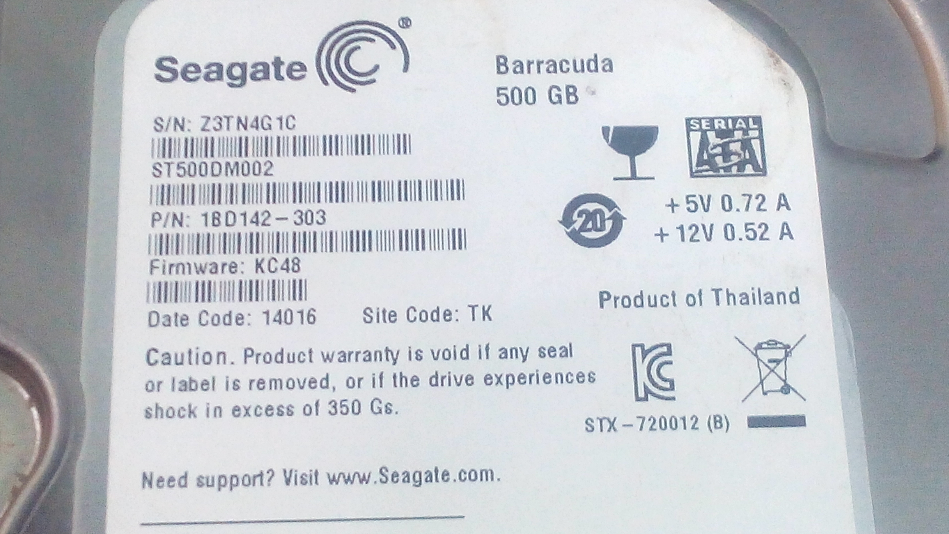

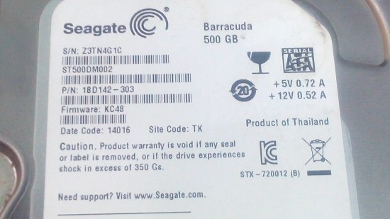

HDD INFO

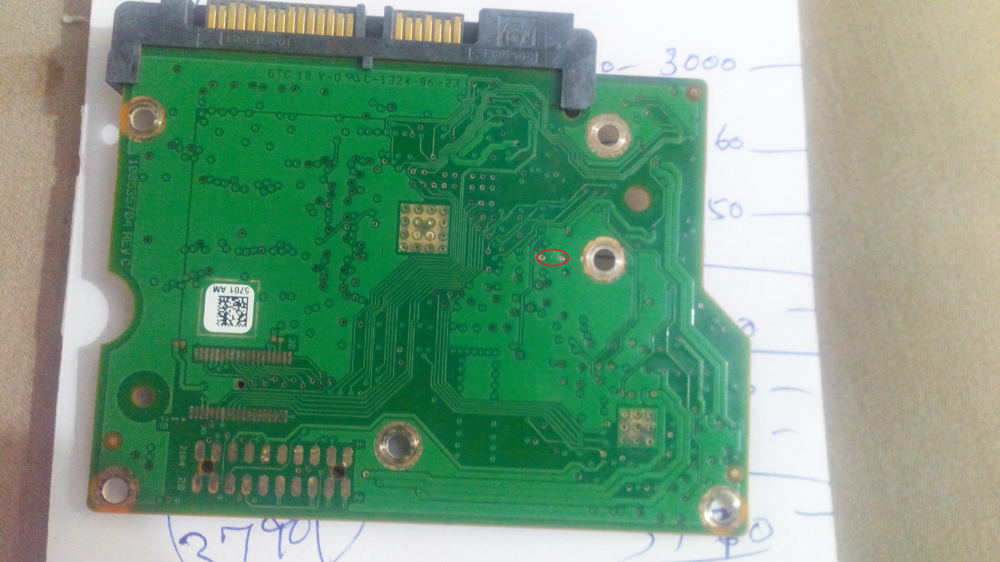

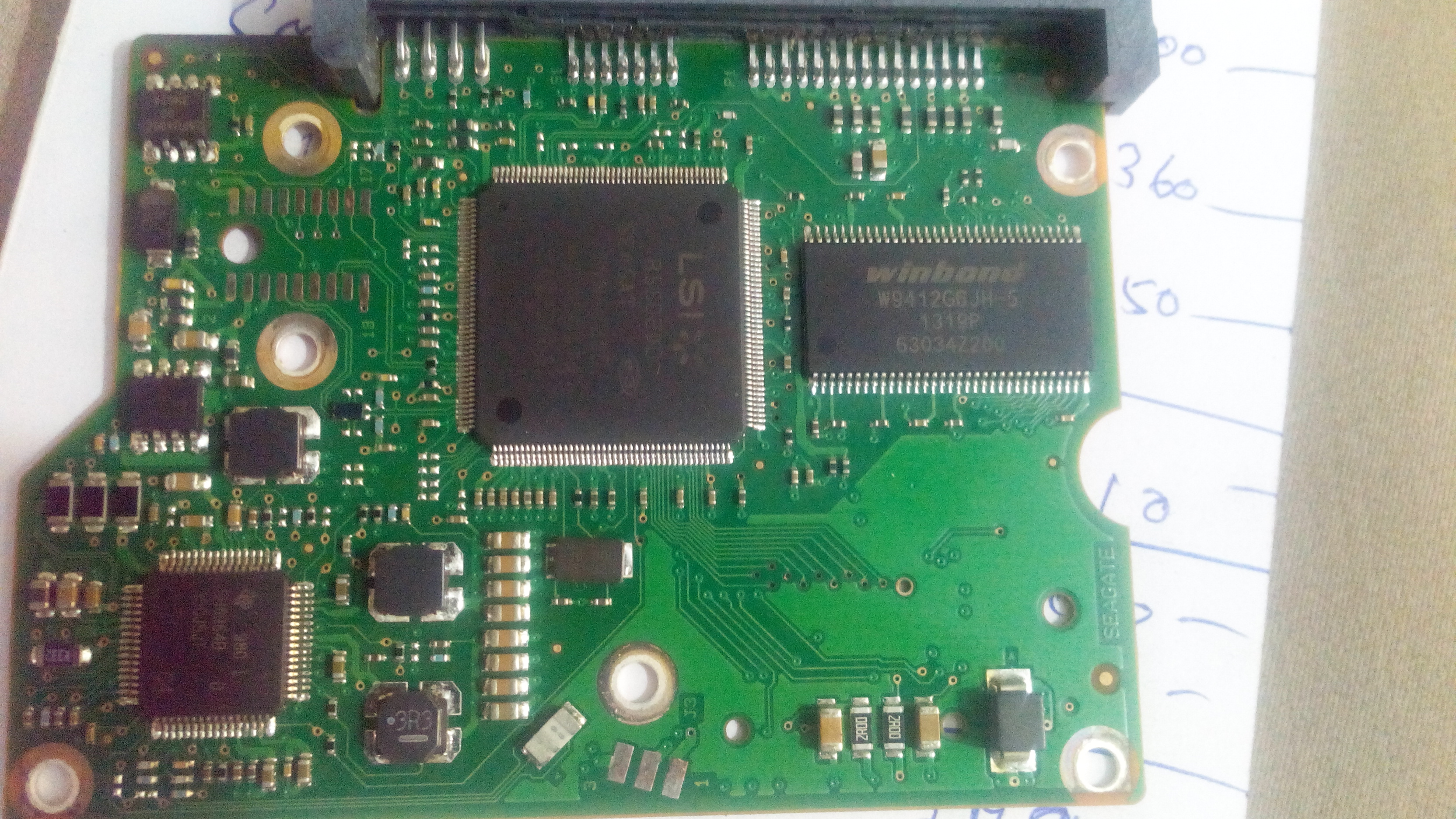

Hello Everyone
No Click Sound and no strange sound but not detected in bios and windows.
Just spinng up and Head moves to the edge of the media and stay there , No Spin down.
In Terminal Just got
Boot 0x10M
Spin Up[0x00000000][0x0000B67C][0x0000BA10]
Trans.
Rst 0x10M
MC Internal LPC Process
Spin Up
(P) SATA Reset
Then No Response

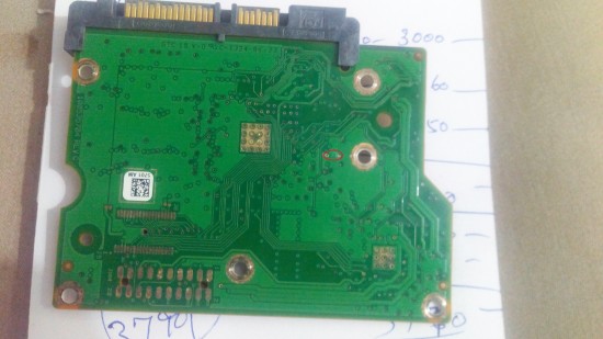

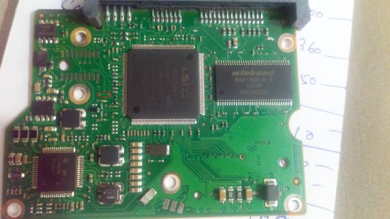

PCB Both Sides
Let me know the How to Short the read channel and when should short them.
Please guide with the procedure.

Which contacts did you short on the PCB?
 Post subject: Re: ST500DM002 Not Detect and No Terminal
PostPosted: June 24th, 2014, 8:58
Posts: 347
Location: india
Thanks for reply

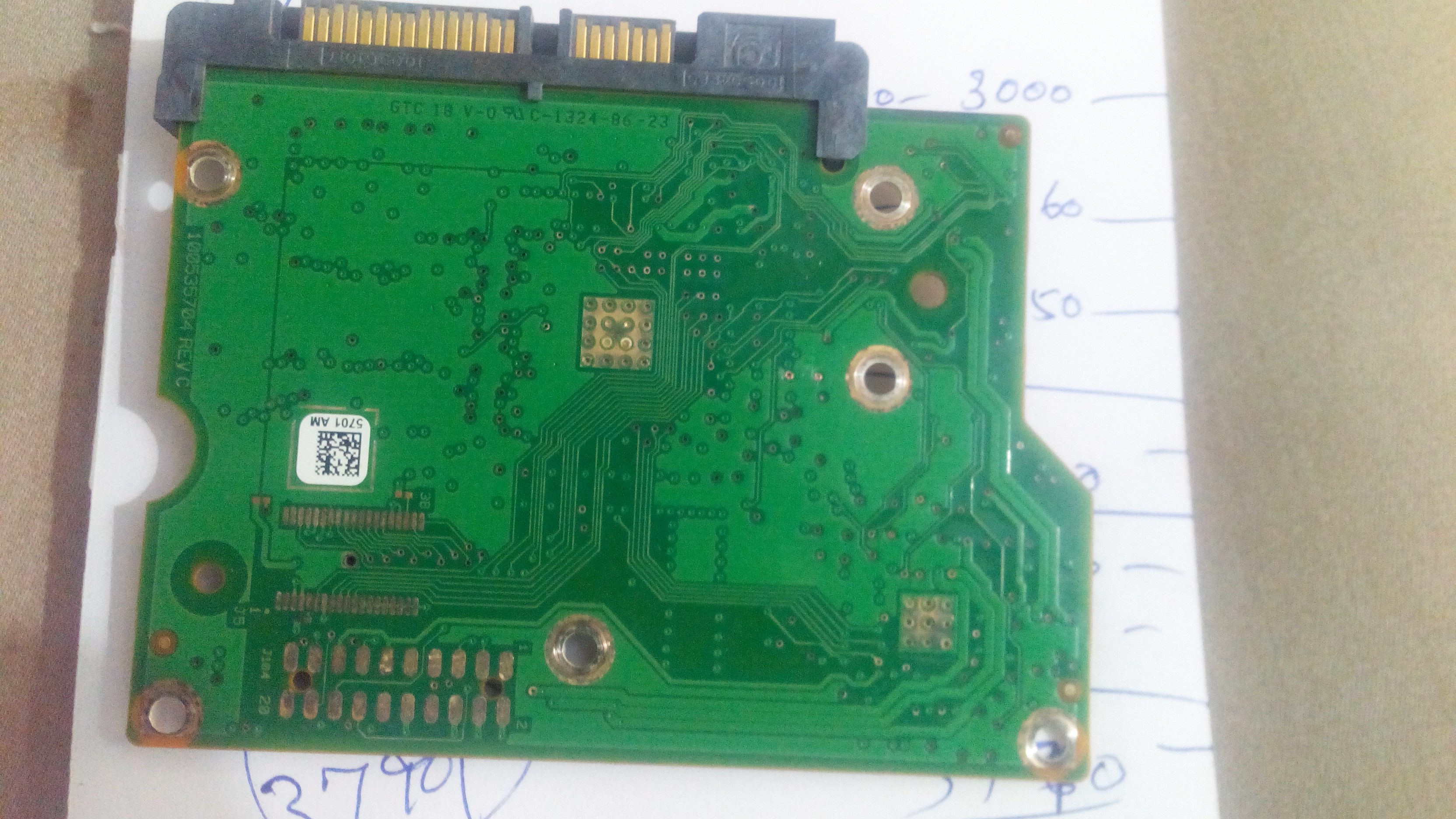

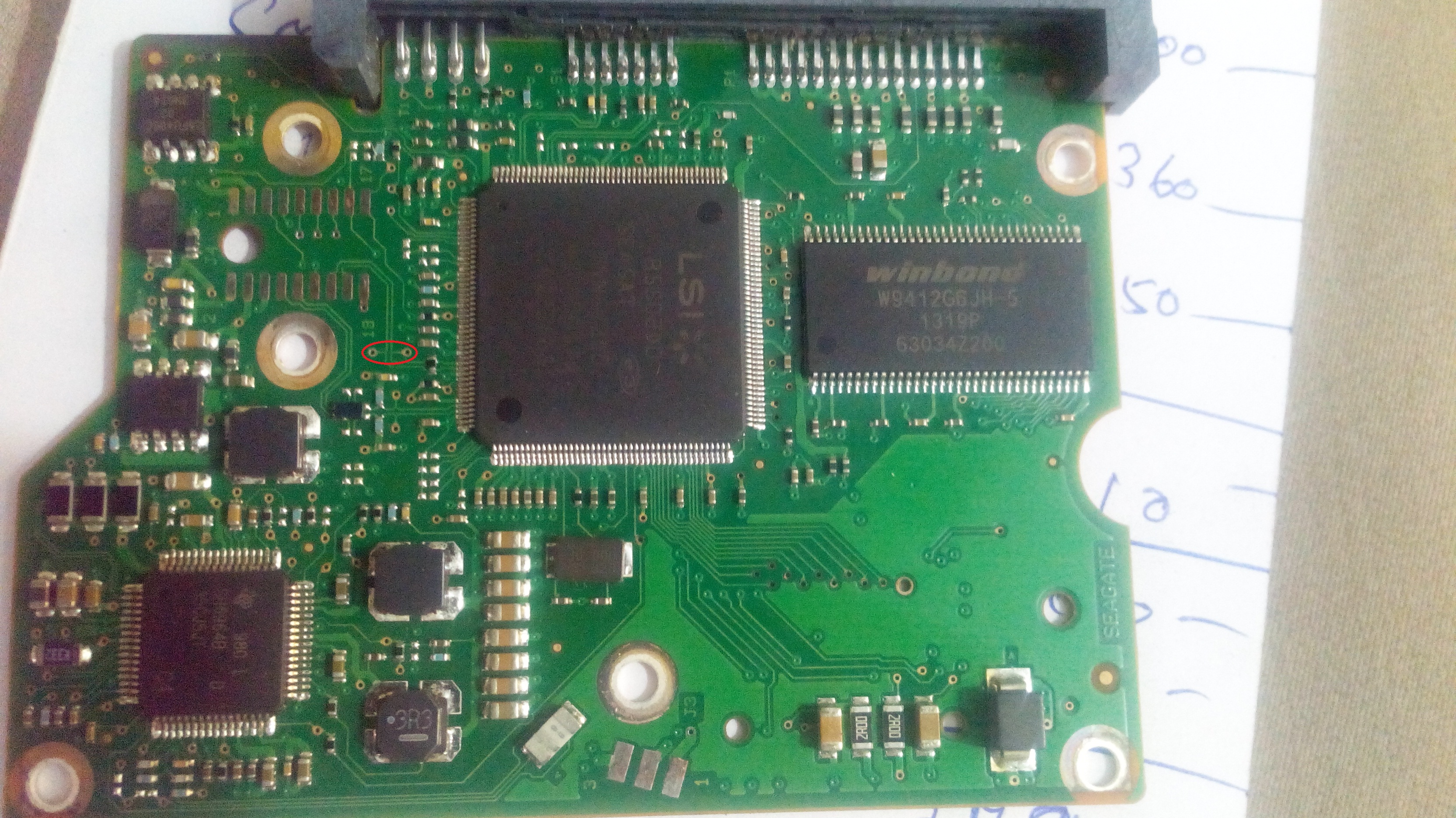

1. MHDD did not see hdd.
2. PCB Change NO EFFECT.
3. Shot ( As per 5th Reply in http://forum.hddguru.com/viewtopic.php?f=13&t=28194 )

Did you click CTRL+Z after Sata reset is shown on the screen ?
No response for Ctrl+Z
just hang with (P) SATA Reset

http://translate.google.co.in/translate?hl=en&sl=ru&u=http://forum.ru-board.com/topic.cgi%3Fforum%3D84%26topic%3D4756%26glp&prev=/search%3Fq%3DFAIL%2B%2BServo%2BOp%253D0155%2BResp%253D0007%2B%2BResponseFrame%2B0000%2B0000%2B0000%2B0000%2B0000%2B0000%2B0000%2B0000%2B0000%2B0000%2B0000%2B0800%25600000%2B0000%2B0000%2B0000%2B000Ax%255B0x00025CB4%255D%255B0x00025CB4%255DZZZZMMMMMMMMMMMMMMMZZZZZZZZZZZZZZZZZ%2BZZZZZZZZZZZZZZZZZZZMMMMMMMMMMMMMMMMMMMMMMMMMMMMMMMMMMMMddddddWWWWMMMMMM%26client%3Dfirefox-a%26hs%3D3Zj%26rls%3Dorg.mozilla:en-US:official%26channel%3Dsb
When you turn the spindle spins without extraneous sounds system and the BIOS is not detect, it is necessary to close the read channel recording, reading and closes here that occur Spin Up [0x00000000] [0x0000B67C] [0x0000BA10]
is it correct ? but I could not lock terminal
