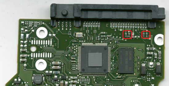

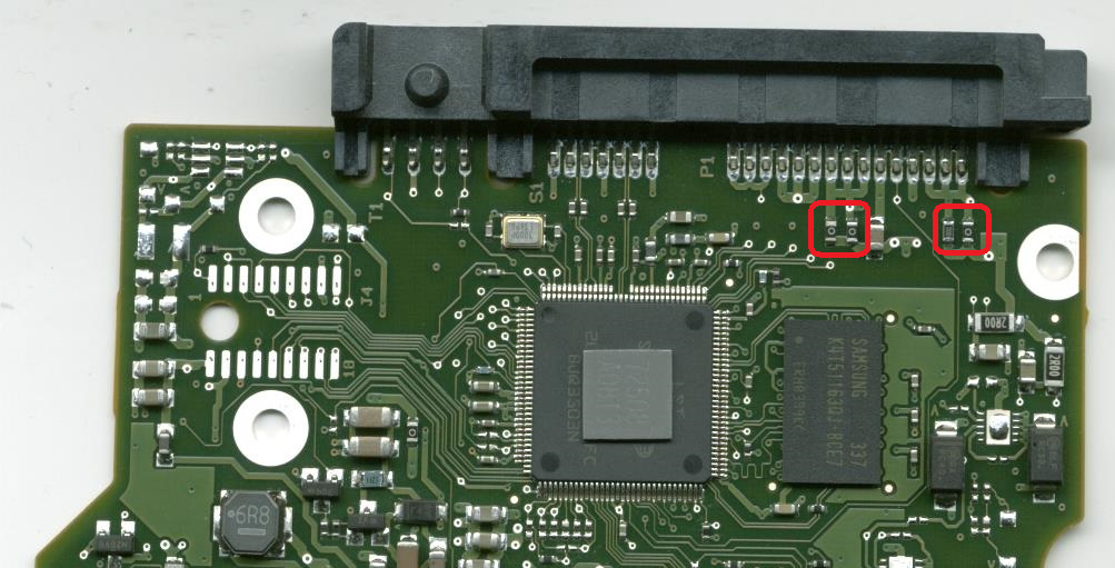

Thanks; visually not burned diodes or other ones. i'll do testing and report here.
I test de PCB. i think not Diodes in this case.
I think tehre are 4 fuses. i atach pic (not real pic. googled pic)
in case of fuses they are not shorted
measure is: 0.001 Ohm
 Post subject: Re: ST ST2000DM001 Stops spining
PostPosted: June 25th, 2014, 16:10
Posts: 17226
The motor windings should measure around 1 ohm, maybe less. The zero ohm resistors should measure 0 ohms. You should be using the 200 ohms scale for your measurements.
