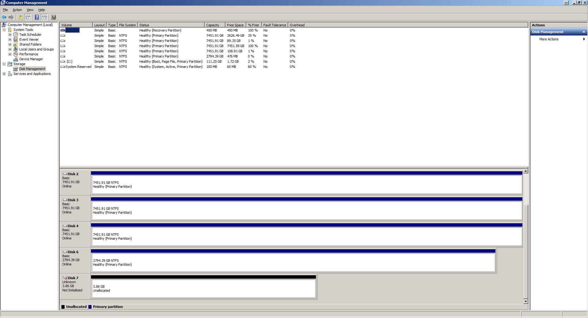

I have a brand new 8 TB hard drive that is reporting as only 3.86 GB in Disk Management. Obviously, I could send the drive back, but is there any fixing it as an alternative? Just checking... Thank you in advance.
File comment: Bottom one in Disk Management

Have you bought it from a reliable source? Maybe it is just a fake.

Try the following in command prompt under administrator.
Type “diskpart” after the command prompt to start the Disk Partition utility. This should result in a DISKPART command prompt.
Type each of the following commands, one at a time, after the DISKPART prompt, pressing “Enter” after each:
list disk
select disk # (select the disk number that shows 3.86GB as capacity)
clean
create partition primary
select partition 1
active
format FS=NTFS (this will take sometime)
assign
exit
The disk should be back to full capacity. If not then i would send it back as its probably a fake.

If you right click where it says "not initialized" and select properties, what model no. is shown?

Doesn't the symptom reflect a problem with SA access? Isn't this what you see if you remove the PCB and access it on its own?
Does the drive spin up? Any bad noises?

3.86GB... Is it a Seagate? ;)
Exactly so, looks like DOA
