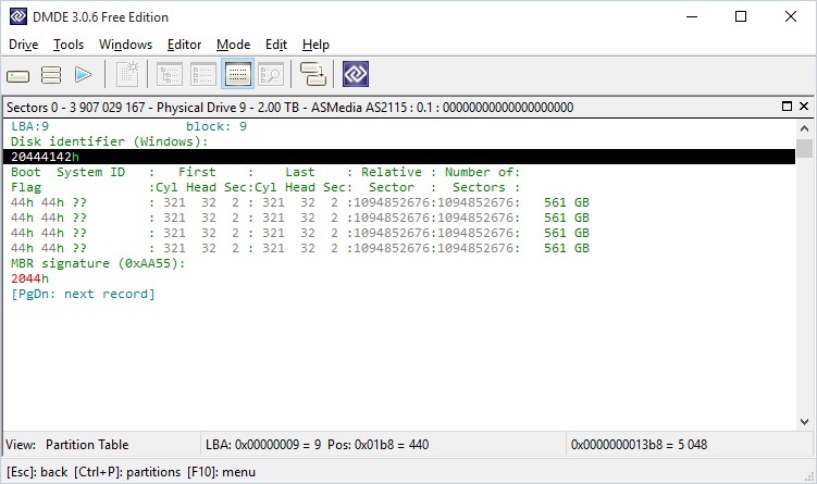

 Post subject: Re: Seagate Barracuda LP 2TB
PostPosted: March 2nd, 2016, 10:09
Joined: February 28th, 2016, 13:54
Posts: 11
Location: New York City
see attached
PostPosted: March 2nd, 2016, 10:23
Posts: 17336
That's LBA 9. We need to see LBA 0.
If you select Mode-> Hex/Text, you will probably see that LBA 9 is filled with "BAD ".
PostPosted: March 2nd, 2016, 13:56
Posts: 11
they all are actually
PostPosted: March 2nd, 2016, 22:01
Posts: 11
fzabkar, LBA:0 is EXACTLY the same as LBA:9 ... also in Hex mode, everysingle line (thousands and thousands of them all say "BAD BAD BAD BAD" at the end.
PostPosted: March 2nd, 2016, 22:26
Posts: 17336
Can you connect the drive to a SATA port rather than a USB-SATA bridge?
Can you see the SMART data?
Users browsing this forum: Google [Bot] and 37 guests
