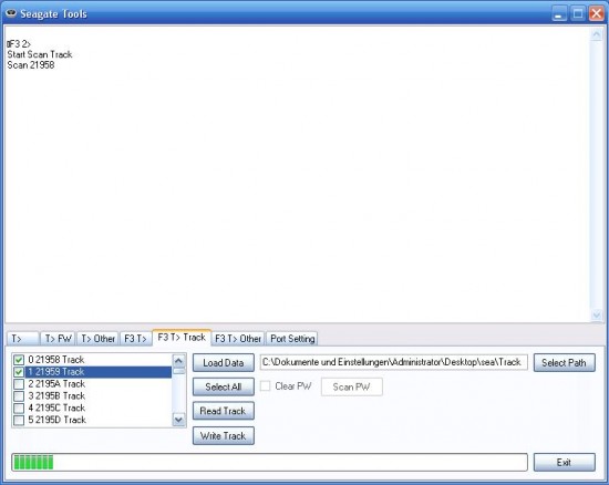

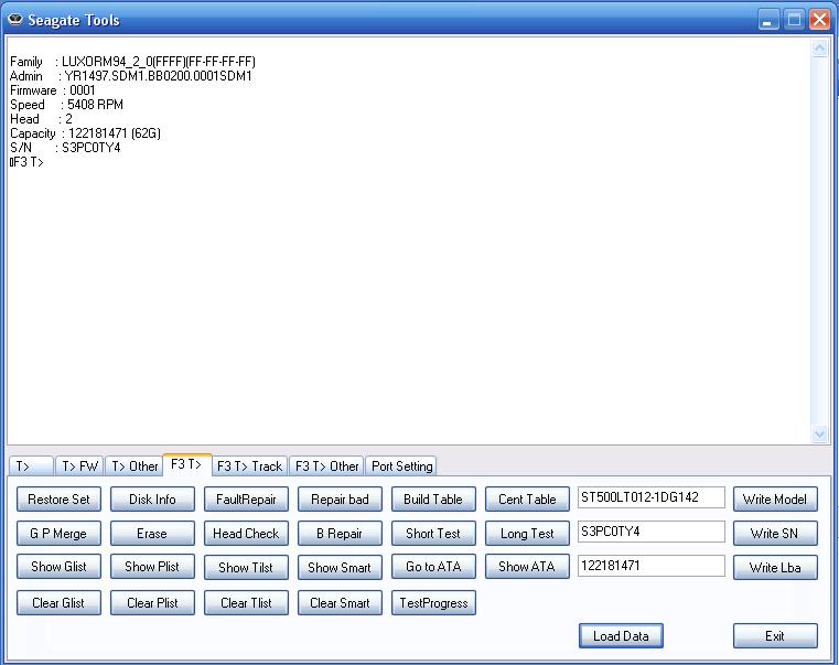

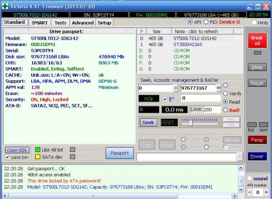

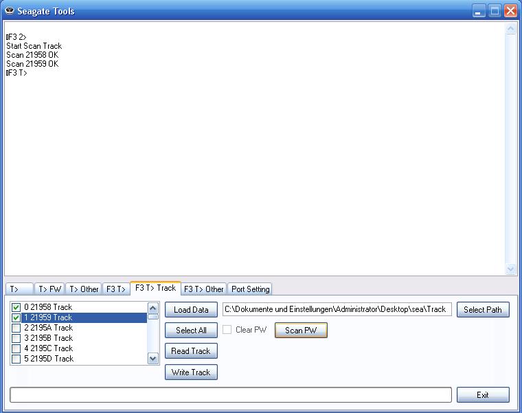

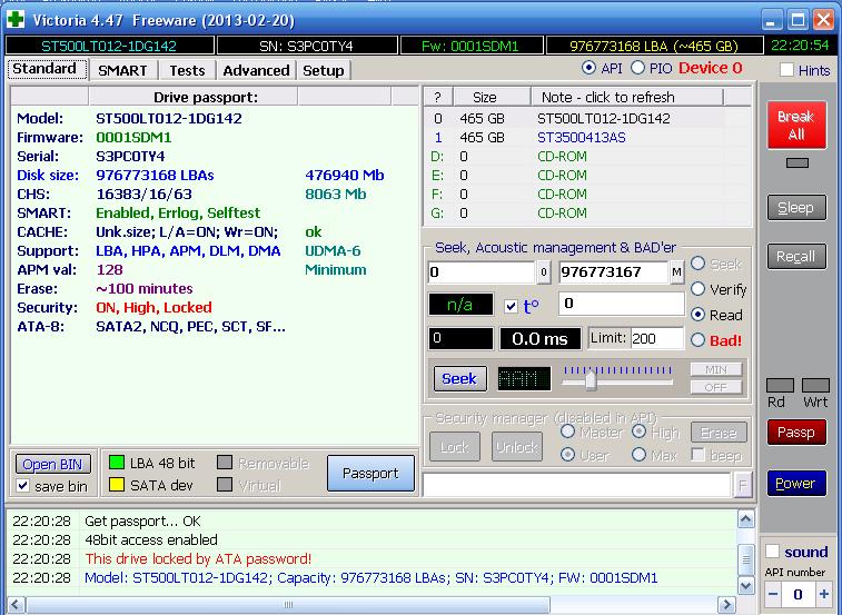

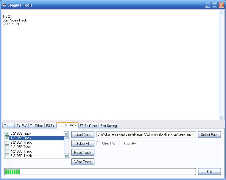

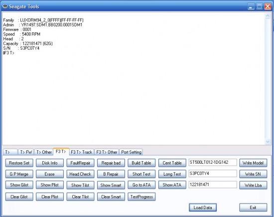

I've some problems with an ATA Locked ST500LT012 i've got from a friend...

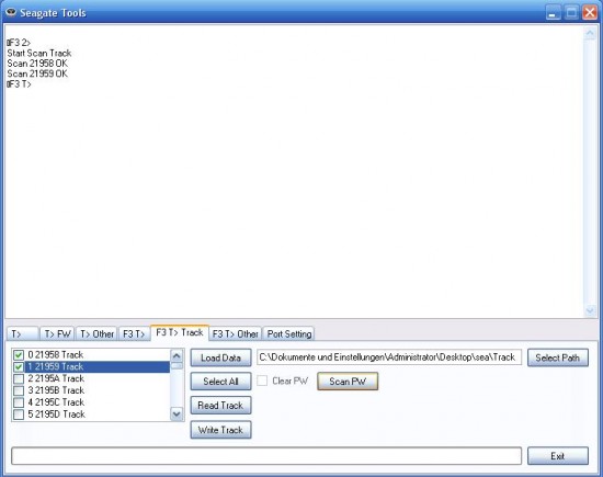

Tried with ZOC and Seagate Tool (F3_hpwlab) but didn't success yet
I use a TTL CP2104 [url]http://www.ebay.de/itm/131749981549
[/url]
It's just connected with TX and RX as the Drive is 1,8V powered
(it's possible to get it connected)
With ZOC I always get error Messages (see Log)
With Seagate Tool I don't get password (don't know whicht track to scan for Password) and empty Track Reads
I've give it a new try today but still without success :cry:
Last time I just connected SATA Power, RX and TX from TTL Adapter to the Drive.
Now I also conneted GND from TTL adapter to the Drive...
Maybe this was the reason for SIM and RAW Error last time...
I also tried different buffer settings when i was asked this time - don't know what it is for...
Last time I just did what I've wrote...
I didn't use "m" command or anything else I shouldn't do yet ;)
Just have these Programs from Internet I can work with (Freeware)
Script always stopps with error on line 176 and Bad Buffer Blocks...

replace 0A30 ==> 1C00 dialogue
the script runs on ST500LT012 I specifically checked.

next attemp today...
Many thanks to Moltke!!!
After some attemps I got two different "PWD.bin" files
some with password "2708 " - seems to don't work
others with password "fuck " - seems to don't work
Tried to add file in Victoria which told me that filesize isn't correct...
So I opened with Editor and copy/past to Victoria
but still no luck
Error after DISPWD, Error: ABRT
After some more tries and hundreds of reboots i tried it without spaces after password...
Password "fuck" seems to work now
Victoria told me now:
Send password: "fuck". Type: MASTER
Starting security ERASE, ~100 min.
Now I have to be patient and wait till Security Erase is finished ;)
