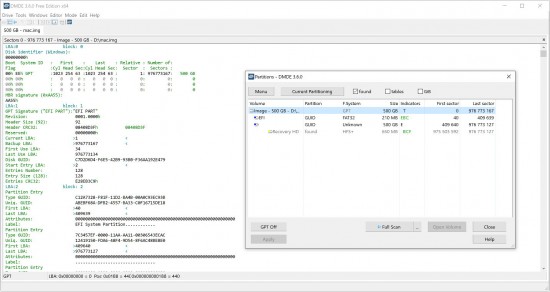

I opened the .img with DMDE successfully, so the .img is probably not corrupted, however it seems that this program cannot find APFS partitions

guix,
DMDE 3.7.1.779 Beta (2020-08-15)
N APFS support (without encryption)

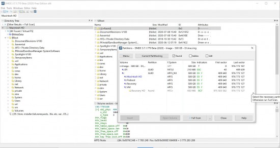

Yes! With the latest beta, it worked... Thanks all ;)
SOLVED
