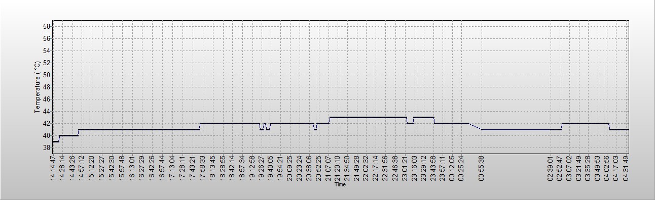

Problem now is that it didn't bypass all bad sectors, anybody knows how to do that manually?
20220202-094719_WR_ST3000DM001-1CH166_S1F0QFQX_CC43-perf.jpg [ 131.89 KiB | Viewed 13070 times ]
20220202-094711_WR_ST3000DM001-1CH166_S1F0QFQX_CC43-temp.jpg [ 139.7 KiB | Viewed 13070 times ]
20220202-094642_WR_ST3000DM001-1CH166_S1F0QFQX_CC43-surface-full.jpg [ 996.24 KiB | Viewed 13070 times ]

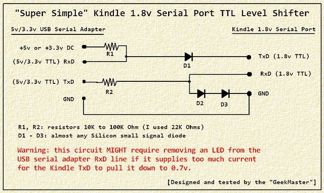

I forgot to mention, there was problem with level shifter, I was using simple one that I found on this forum (diodes and resistors)

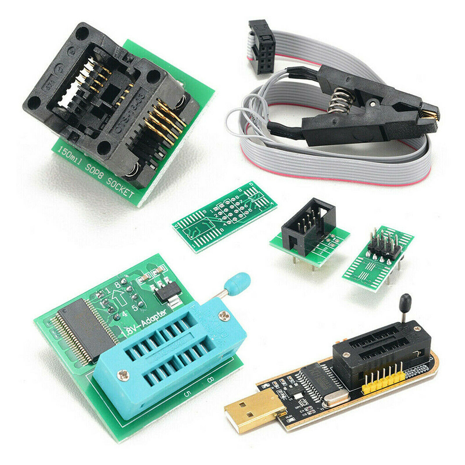

It only worked time to time. I've got transistor based ready-made voltage translator, that one works 100%, just 1,8V supply need big capacitor (I've used 1000uF/6.3V)
And I am using CH341a programmer, with 1.8V adapter and NeoProgrammer it can read and write bios chip (I did test that, so no more soldering), in serial mode it needs that voltage translator.
