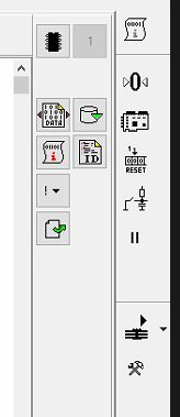

guys i still dont know how to find the preamp with pc-3000................. CTRL+L doesnt work.

hello guys is there a way to find out the preamp from the ROM file when the head died??
i cant find this feature with the latest pc-3000 update .......

https://blog.acelab.eu.com/pc-3000-for- ... rsion.html
You can do it from ROM dump and using Hex Editor. Works for all F3 drives except Rosewood.

Sir is the V9 a rosewood? my utility seems different from the one on the link you sent me. i dont have PS Physical Heads map button
