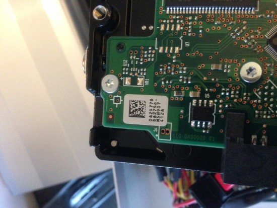

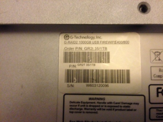

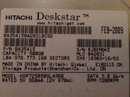

 Post subject: Need PCB for Hitachi Deskstar 500GB HDP725050GLA360
PostPosted: September 8th, 2011, 19:37
Joined: September 8th, 2011, 19:27
Posts: 11
Location: Los Angeles
I need to find a PCB for this drive. Appreciate any help locating. Bought similar model HD on Ebay but slightly different PCB unfortunately, so no joy. Can't find anything current on Ebay and am not sure of PCB model #. Is it printed on white sticker? Anyway, have tried googling all numbers from sticker and chips but still no luck.
White Sticker:
0A29778
BA2798-
Z2R837
0A53
rectangular chip:
Samsung 725
K4S281632I-UC60
printed on PCB:
110 0A900026 01
pcb1.jpg [ 648.44 KiB | Viewed 16157 times ]
 Post subject: Re: Need PCB for Hitachi Deskstar 500GB HDP725050GLA360
PostPosted: September 8th, 2011, 19:40
Why do you need a new pcb?
 Post subject: Re: Need PCB for Hitachi Deskstar 500GB HDP725050GLA360
PostPosted: September 8th, 2011, 19:48
Joined: September 8th, 2011, 19:27
Posts: 11
Location: Los Angeles
Data recovery. Drive won't spin up.
 Post subject: Re: Need PCB for Hitachi Deskstar 500GB HDP725050GLA360
PostPosted: September 8th, 2011, 19:54
Joined: September 8th, 2011, 19:27
Posts: 11
Location: Los Angeles
pic of label
IMG_0630.JPG [ 112.37 KiB | Viewed 16152 times ]
 Post subject: Re: Need PCB for Hitachi Deskstar 500GB HDP725050GLA360
PostPosted: September 8th, 2011, 20:21
Need a higher resolution picture. What do you think happened for the board not to spin?
 Post subject: Re: Need PCB for Hitachi Deskstar 500GB HDP725050GLA360
PostPosted: September 8th, 2011, 20:45
Joined: September 8th, 2011, 19:27
Posts: 11
Location: Los Angeles
I'll try to get a better resolution picture of the board up in a few minutes.
No idea on what happened to the drive. It belongs to a client and came out of a G-Tech G-Drive.
 Post subject: Re: Need PCB for Hitachi Deskstar 500GB HDP725050GLA360
PostPosted: September 8th, 2011, 20:52
As an evaluation prerequisite, it is a good idea to ask customers what they think happened with the drive.
It may help validate some of the findings when running tests.
 Post subject: Re: Need PCB for Hitachi Deskstar 500GB HDP725050GLA360
PostPosted: September 8th, 2011, 20:55
Joined: September 8th, 2011, 19:27
Posts: 11
Location: Los Angeles
I did ask. The client had no idea.
 Post subject: Re: Need PCB for Hitachi Deskstar 500GB HDP725050GLA360
PostPosted: September 8th, 2011, 21:41
Joined: September 8th, 2011, 19:27
Posts: 11
Location: Los Angeles
Pictures attached are close ups of chips on PCB
pcb1.jpg [ 648.44 KiB | Viewed 16134 times ]
IMG_1073.jpeg [ 47.05 KiB | Viewed 16136 times ]
IMG_1072.jpeg [ 37.51 KiB | Viewed 16136 times ]
 Post subject: Re: Need PCB for Hitachi Deskstar 500GB HDP725050GLA360
PostPosted: September 8th, 2011, 22:13
The diode seems like it may be burnt, but cannot quite tell. Need a better picture, preferably taken from up top.
Search for diode here on the forum to learn how to test using a multimeter.
 Post subject: Re: Need PCB for Hitachi Deskstar 500GB HDP725050GLA360
PostPosted: September 8th, 2011, 22:40
Joined: September 8th, 2011, 19:27
Posts: 11
Location: Los Angeles
Will do, thanks for the suggestion. Just gotta locate my multimeter.
Will also try to get a better pic - been farming the pics out to my wife after failing with my original iphone pics.
 Post subject: Re: Need PCB for Hitachi Deskstar 500GB HDP725050GLA360
PostPosted: September 9th, 2011, 13:36
Joined: September 8th, 2011, 19:27
Posts: 11
Location: Los Angeles
Various pics of the diodes, etc.
IMG_1098.jpeg [ 46.48 KiB | Viewed 16078 times ]
IMG_1102.jpeg [ 45.77 KiB | Viewed 16078 times ]
IMG_1100.jpeg [ 44.39 KiB | Viewed 16078 times ]
IMG_1095.jpeg [ 27.97 KiB | Viewed 16078 times ]
 Post subject: Re: Need PCB for Hitachi Deskstar 500GB HDP725050GLA360
PostPosted: September 9th, 2011, 22:38
Joined: September 8th, 2011, 19:27
Posts: 11
Location: Los Angeles
Cannot locate test leads for multimeter! :(
It's got the clamp leads on it which makes testing small diodes difficult. Have ordered replacement set from Mouser, but the diodes don't look physically burned out to the naked eye. Sorry about the small pix.
Anyone on the board do PCB repairs and wants to take a look at this one? For pay, of course. :)
 Post subject: Re: Need PCB for Hitachi Deskstar 500GB HDP725050GLA360
PostPosted: September 12th, 2011, 0:36
Joined: September 8th, 2011, 19:27
Posts: 11
Location: Los Angeles
I"ve seen posts about flashing firmware on PCB's to make them work with different hard drives. I have an almost identical PCB from the same model hard drive. Can I flash the firmware to make it work with this drive?
 Post subject: Re: Need PCB for Hitachi Deskstar 500GB HDP725050GLA360
PostPosted: September 12th, 2011, 23:29
"Almost identical" is not enough to say if it will work or not. Typically, matching the first two lines on the PCB's white label should make board compatible. This is just the starting point for this. Then you have to make donor PCB work with the drive by transferring adaptive information.
 Post subject: Re: Need PCB for Hitachi Deskstar 500GB HDP725050GLA360
PostPosted: September 16th, 2011, 4:25
Posts: 849
Can you hear some "buzz" noise from the drive? If yes, forget about PCB exchange - most likely the diagnose is "head stiction".
 Post subject: Re: Need PCB for Hitachi Deskstar 500GB HDP725050GLA360
PostPosted: September 16th, 2011, 12:48
Joined: September 8th, 2011, 19:27
Posts: 11
Location: Los Angeles
No buzz. Drive just did not spin up at all. With donor PCB (from board with same two lines on white label), the drive would spin up but would not read. Tried swapping ROM chip from original board to donor board, but same result.
 Post subject: Re: Need PCB for Hitachi Deskstar 500GB HDP725050GLA360
PostPosted: December 31st, 2013, 9:19
Joined: December 31st, 2013, 8:55
Location: London UK
Hi Everyone
Apologies to re-ignite an old post, but I have almost the exact same HDD/PCB that is being talked about here, with exactly the same problem, and stupidly, it houses the only copy of some very very important data. I am going to have to bite the bullet if I cant fix this myself and take it to a professional recovery place, but if I can save £500 (or USD $750) then all the better.
So here is what happened:
The HDD in question is from a G-RAID 2 1TB Enclosure, which as far as I am aware was setup as RAID 0. This RAID has been working without fault since it was bought in 2009, and a few days ago, after being brought home from a visit to my workplace, does not work. The light comes on, I can hear the fan start, but aside from that, NOTHING. Not mounting on a PC or mac, with multiple AC adapters and firewire/usb cables being tested - NOTHING.
I then opened up the enclosure as it is way out of the warranty period. All appears to be in order - nothing is burned, broken or looking bad to me. There are 2 x 500gb drives inside (striped to make 1TB) and they sit one on top of the other with a cradle in between them. Having fired it up again, I realised that the drive at the top is spinning, no bad noises, all fine. But the bottom drive - is not. No buzzing, no spinning, no vibrations - NOTHING at all.
I then thought I should test both drives individually, so I went out and bought a SATA-USB caddy. Again, the drive that is powering up, still powers up in the caddy, the drive didn't - still DOES NOT!
I get a "this disk must be initialized" error when I mount the one that powers up on my mac - which makes sense to me as they are a striped RAID set so they need to be mounted together. I did a deep scan last night with that drive on disk drill - but as expected, only very small documents or pictures were appearing properly, everything else does not appear at all and if it does, its garbled. Please correct me if I am wrong but this is because there are fragments of these files on both drives which have to be present to use these files properly.
Now, what I need to know is, what are my options? I have read alot of forums where people have had success by replacing PCB Boards and ROM Chips and the drive has worked again. I have also read other stories where it hasnt and the only option is then data recovery. I have uploaded pictures of:
G-RAID Sticker at the bottom of the Enclosure
Sticker on top of the HDD
Sticker on the PCB Board
Please please can ANYONE help?!
Taj
File comment: PCB
photo 1.JPG
photo 1.JPG [ 612.92 KiB | Viewed 15259 times ]
File comment: HITACHI DESKSTAR 500GB HDD (Feb 2009)
photo 2.JPG
photo 2.JPG [ 674.4 KiB | Viewed 15259 times ]
File comment: G-RAID 2 1TB
photo 3.JPG
photo 3.JPG [ 654.77 KiB | Viewed 15259 times ]
 Post subject: Re: Need PCB for Hitachi Deskstar 500GB HDP725050GLA360
PostPosted: January 5th, 2014, 8:11
Posts: 849
Is this a test? :shock:
The PCB is missing the NVRAM chip!
 Post subject: Re: Need PCB for Hitachi Deskstar 500GB HDP725050GLA360
PostPosted: January 5th, 2014, 10:06
Joined: April 7th, 2013, 13:17
Posts: 192
Location: indian
i have this pcb fuzztone65 you want to buy ?
Users browsing this forum: No registered users and 199 guests
