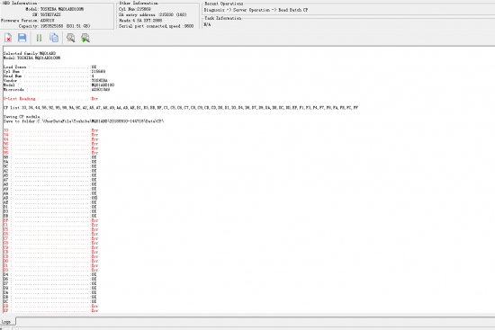

 Post subject: Model: TOSHIBA MQ01ABD100M ( G-list Error )
PostPosted: September 10th, 2018, 5:59
Joined: September 10th, 2018, 5:48
Posts: 97
Toshiba 2.5" 1TB
G-List Error
Smart Cleared
G-List Clear Error
User Sector Error, Any Help or suggestion?
Selected family:MQ01ABD
Model:TOSHIBA MQ01ABD100M
Load Zones : .........................:OK
Cyl Num : ............................:215669
Head Num : ...........................:4
Vendor : .............................:TOSHIBA
Model : ..............................:MQ01ABD100
Microcode : ..........................:AXG01UA9
G-List Reading : .....................:Err
CP list:33,34,44,56,92,95,98,9A,9C,A2,A5,A7,A8,A9,AA,AD,AE,B1,B3,BB,BF,C1,C5,C6,C7,C8,C9,CB,CD,D0,D1,D3,D4,D6,D7,D9,DA,DB,DC,DD,EF,F1,F3,F4,F7,F8,FA,FB,FC,FF
Saving CP module......
Save to folder:C:\UserDataFile\Toshiba\MQ01ABD\20180910-144718\Data\CP\
33 : .................................:Err
34 : .................................:Err
44 : .................................:Err
56 : .................................:Err
92 : .................................:Err
95 : .................................:Err
98 : .................................:OK
9A : .................................:OK
9C : .................................:OK
A2 : .................................:OK
A5 : .................................:OK
A7 : .................................:OK
A8 : .................................:OK
A9 : .................................:OK
AA : .................................:OK
AD : .................................:OK
AE : .................................:OK
B1 : .................................:OK
B3 : .................................:OK
BB : .................................:OK
BF : .................................:Err
C1 : .................................:Err
C5 : .................................:Err
C6 : .................................:Err
C7 : .................................:Err
C8 : .................................:Err
C9 : .................................:Err
CB : .................................:Err
CD : .................................:Err
D0 : .................................:Err
D1 : .................................:Err
D3 : .................................:Err
D4 : .................................:OK
D6 : .................................:OK
D7 : .................................:OK
D9 : .................................:OK
DA : .................................:OK
DB : .................................:OK
DC : .................................:OK
DD : .................................:Err
EF : .................................:Err
F1 : .................................:Err
F3 : .................................:Err
F4 : .................................:Err
F7 : .................................:Err
F8 : .................................:Err
FA : .................................:Err
FB : .................................:Err
FC : .................................:Err
FF : .................................:Err
CP Saving module is ok!
Toshiba 2.5.PNG
Toshiba 2.5.PNG [ 29.34 KiB | Viewed 16212 times ]
 Post subject: Re: Model: TOSHIBA MQ01ABD100M ( G-list Error )
PostPosted: September 10th, 2018, 16:58
Posts: 17215
Can you upload the resources, including a ROM and track dump?
I suspect that most of the CP errors are bugs in your tool.
 Post subject: Re: Model: TOSHIBA MQ01ABD100M ( G-list Error )
PostPosted: September 10th, 2018, 18:16
Joined: July 12th, 2010, 4:38
Posts: 1455
I think the problem should be no accessing SA/Data area. Probably bad heads or media damage, since he can only read CP from PCB and nothing from SA...
ACELab partner
 Post subject: Re: Model: TOSHIBA MQ01ABD100M ( G-list Error )
PostPosted: September 11th, 2018, 7:43
Joined: September 10th, 2018, 5:48
Posts: 97
Track 1 damaged, need to read it first, than write it to repair the logical damage.
 Post subject: Re: Model: TOSHIBA MQ01ABD100M ( G-list Error )
PostPosted: September 11th, 2018, 16:30
Posts: 17215
pclab wrote:
I think the problem should be no accessing SA/Data area. Probably bad heads or media damage, since he can only read CP from PCB and nothing from SA...
There are several "Err" CPs which are ROM resident, eg 33, 92, 95. I believe these "errors" are due to a bug in the tool rather than a damaged ROM. A ROM dump would enable us to confirm this. In any case these false errors are obfuscating the real problem.
 Post subject: Re: Model: TOSHIBA MQ01ABD100M ( G-list Error )
PostPosted: September 11th, 2018, 18:21
Joined: July 12th, 2010, 4:38
Posts: 1455
MRT does that even on healthy drives, so I don't care it too much.
ACELab partner
 Post subject: Re: Model: TOSHIBA MQ01ABD100M ( G-list Error )
PostPosted: October 23rd, 2018, 10:46
Posts: 474
Location: spain
Have you given the case closed or do you want to get the data from that disk?
Users browsing this forum: No registered users and 93 guests
