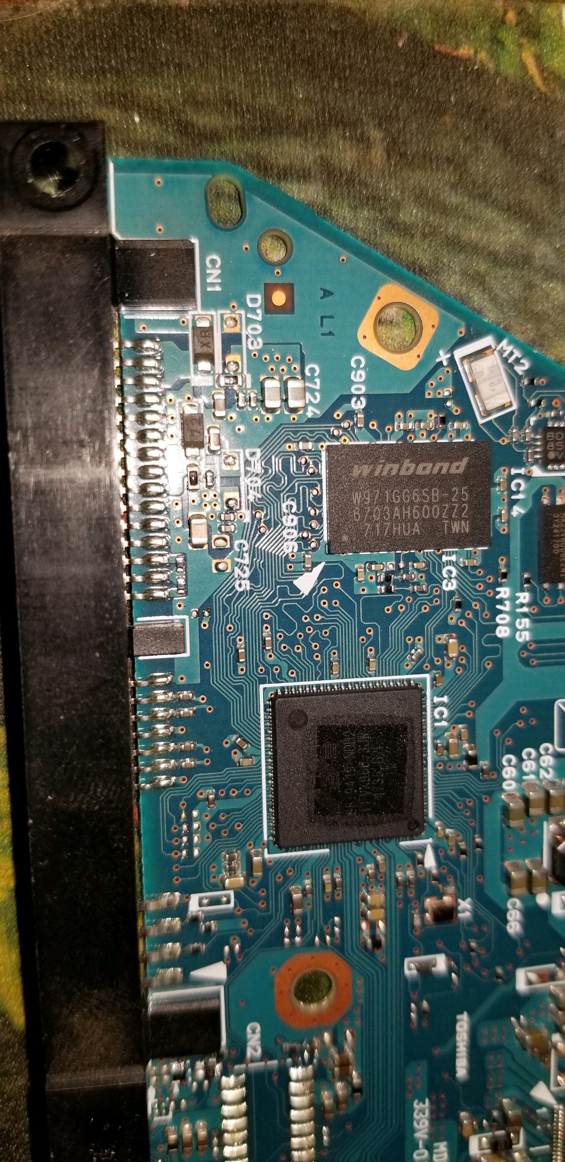

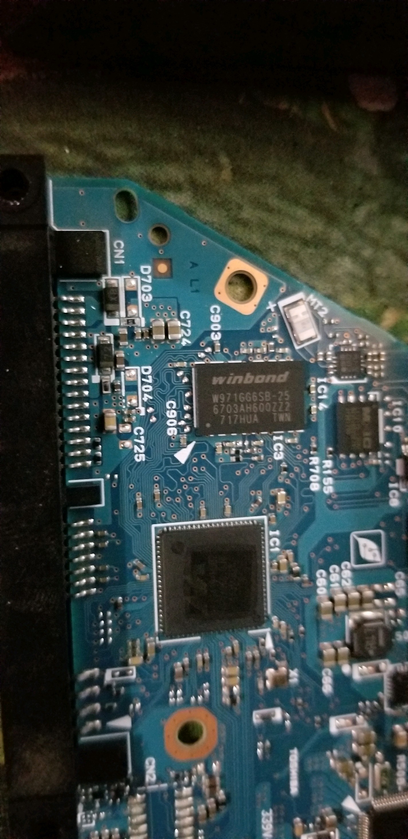

I came across this while searching for answers and found this thread. I have a Toshiba X300 5TB HDD that has the same issue. I had missed a power cord when changing power supplies, found my SSD which is attached to same power cord works fine, but my Toshiba doesn't spin up, POST in bios, etc. I tried it in my server for S&G's to see if it would spin up and nothing. How similar is the 5TB board to the 6TB board as I am thinking the same issue is going on. I had the board off and well don't remember the measurements, but I think D704 measured .695V fwd and D703 measured .519V fwd, no measurements in reverse of either. I can attach pictures as needed. no damage is visible on the board.

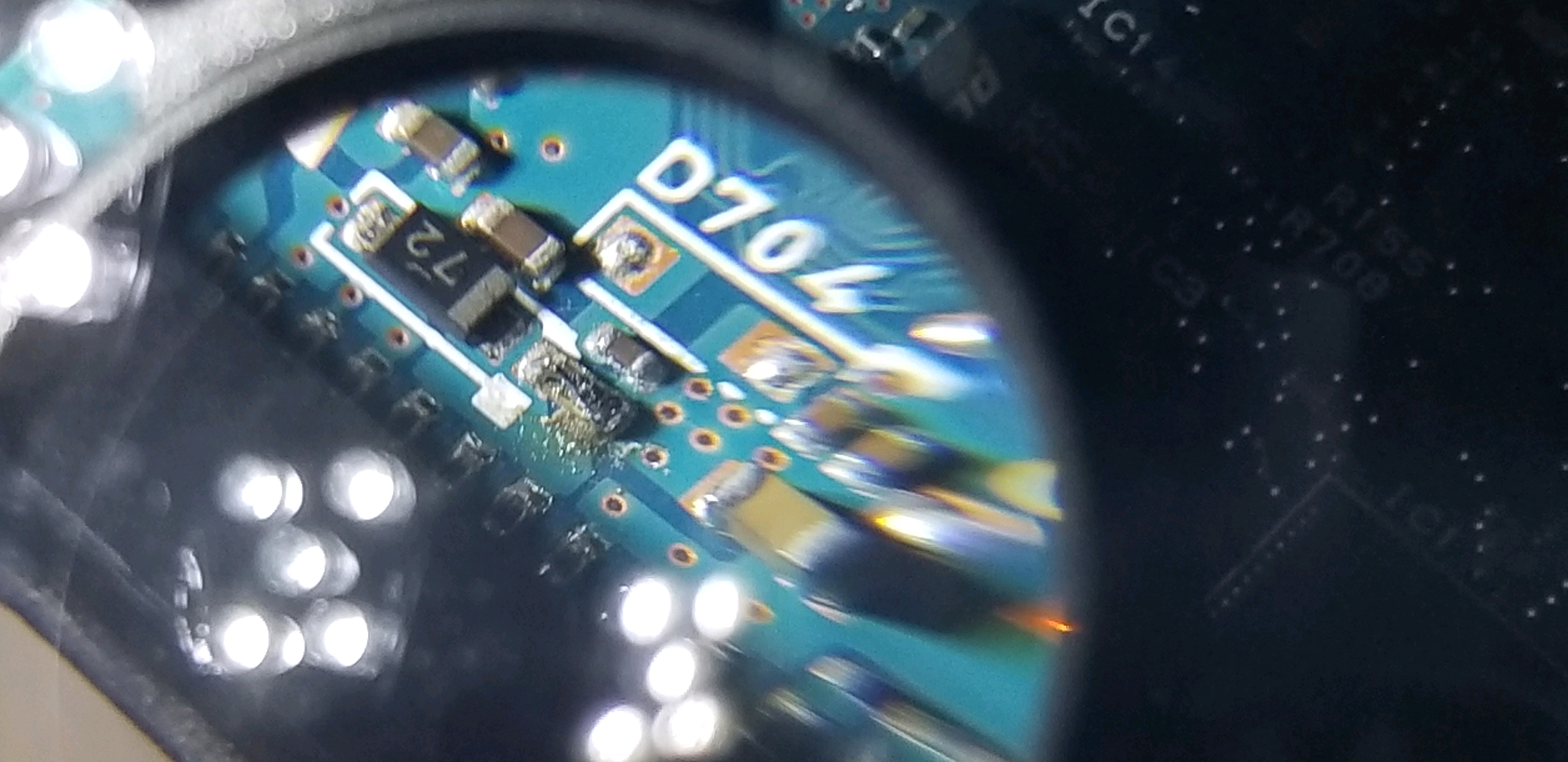

Check the diodes below the indicated pads (marked XB and 72) and the 2 small fuses marked (s and blank) to the right of each. Shorted diodes can be removed, shorted fuses need to be replaced/bridged.

XB fwd voltage is .694, rev is no measurement. 72 is .074 fwd, no measurement in rev. Hard to see what is the fuse as I don't see "s" and "blank" there.

Ok I tried uploading the pics but then everything disappeared and the site said message has to be approved before posting.....so anyways to finish typing now....I was assuming the little black rectangles are the fuses since they are not labelled. The left most one I measured continuity on the meter. the right one for what I believe is the 5V side measures 5 M ohm, sooooo yeah. Ok looking up in the previous messages I can see them more clearly. Yes....S measures continuity at 0 ohms, blank one has the 5M ohm measurement. I had also found on ebay the same exact drive with the same exact revision number, firmware number, and whatever the number is under the serial number. since everything is the same, could I swap boards to get the data off this drive instead of getting the solder station out to replace a fuse the size of a flea? I'm not that steady as to do that but do have the capabilities of hot air solder iron and liquid solder.

No, you would also need to transfer the rom over.
Make sure you have sorted the power cables out before doing anything but bridging / replacing the fuse is the easiest, it doesn't have to be pretty just to recover data. If you're struggling any mobile phone repair shop should be able to do this for beer money.

Is the rom the IC that is embedded so-to-speak in the drive case with 22 pins that contacts the board when the board is screwed back onto the case? if so, how easy is it to pop it out? I'll try first to bridge the fuse when I get home from work. I just need to bridge the fuse for the blank one, since that's the one that had resistance, correct?

The ROM or possibly ROMs are the things that look like IC10. I've not had to do a board swap on these drives but there seems to be a debate about needing to take all 4 , IC9-IC12 or not.
Assuming nothing else has been killed and a full PCB picture would help spot the obvious, you may have been lucky and bridging the open fuse should restore power.
If your data is important (worth 300usd) and you're not comfortable then you may want to hand this off to a DR pro over there.

I bridged the bad fuse....not my best solder job.....and still dead in the water....go figure. IDK what to do next, guess I need to pay to have data recovered from it. I did check it with my meter and it read 0 ohms so it should be good but its not.
