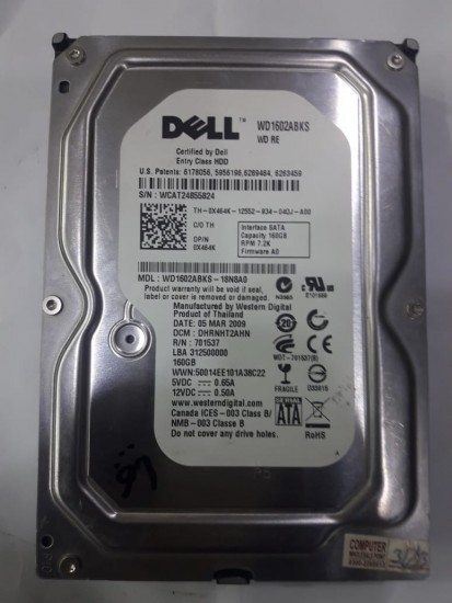

 Post subject: Need Rom
PostPosted: August 28th, 2019, 11:12
Joined: May 6th, 2013, 2:48
Posts: 84
WD1602ABKS-18N8A0
WhatsApp Image 2019-08-28 at 6.41.58 PM.jpeg
WhatsApp Image 2019-08-28 at 6.41.58 PM.jpeg [ 85.47 KiB | Viewed 7201 times ]
WhatsApp Image 2019-08-28 at 6.42.13 PM.jpeg
WhatsApp Image 2019-08-28 at 6.42.13 PM.jpeg [ 122.19 KiB | Viewed 7201 times ]
 Post subject: Re: Need Rom
PostPosted: August 28th, 2019, 11:30
Joined: March 6th, 2010, 3:46
Posts: 627
Location: Kolding | Denmark
What version are you looking for ?
Digitalsupport Data Recovery
https://digitalsupport.dk
 Post subject: Re: Need Rom
PostPosted: August 28th, 2019, 12:11
Joined: May 6th, 2013, 2:48
Posts: 84
digisupport wrote:
What version are you looking for ?
patient pcb is dead replace donor board can't get fw version .
 Post subject: Re: Need Rom
PostPosted: August 28th, 2019, 12:19
Abdul Rauf wrote:
digisupport wrote:
What version are you looking for ?
patient pcb is dead replace donor board can't get fw version .
Did you try to read ROM via the serial port?
Why not use any ROM and recreate ROM from SA?
 Post subject: Re: Need Rom
PostPosted: August 28th, 2019, 12:33
Joined: May 6th, 2013, 2:48
Posts: 84
Did you try to read ROM via the serial port?
76868.jpg [ 208.28 KiB | Viewed 7174 times ]
 Post subject: Re: Need Rom
PostPosted: August 29th, 2019, 7:08
Posts: 489
Location: Usa
Abdul Rauf wrote:
Did you try to read ROM via the serial port?
Select random family. 》go in WD marvel. 》stop action. 》power of on
Pres the button seems bios chip that above test menu》 boot rom mode 》 continue this screen and mostly possible to read rom here
If not work (mostly working) desolder bios and read by external chip reader. Etc etc
But in Picture that you added , look like PCB failure. Look bottom. Drive not ready or busy. Cause
1) PCB or TVS failure or 0 ohm resistor problem.
2) wrong or corrupted ROM
Sexy Womans from your town
Users browsing this forum: Majestic-12 [Bot] and 231 guests
