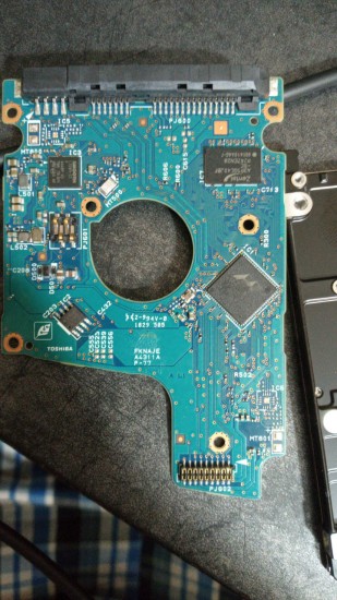

Hello, I just ordered a new self drive. Meaning a drive for personal to experiment and learn.
I was under two expectations...
1)It will be a JMVW (India still has some old stock). Great if its a JMVW, Donors are damn expensive.
2)It will be a palmer which I can play with (apparently, the 20b/0B changes reflect well, Like fault introduction by tv9 10 short == bypassing 11 in the said mods,411 gets bypassed and so does 02 however the SED situation fails to resolve.So now I have requested a dump of RAM and will try about 24 shortlisted modules one by one creating a hit or a miss situation)
turns out its a WD with Toshiba PCB
heres the ROM dump
The drive shows SA lock features.
Simran
PS:Why cant I upload the ROM code here?
btw it starts with ASCII : TOSHIBA header unlike 'Z' in WD.

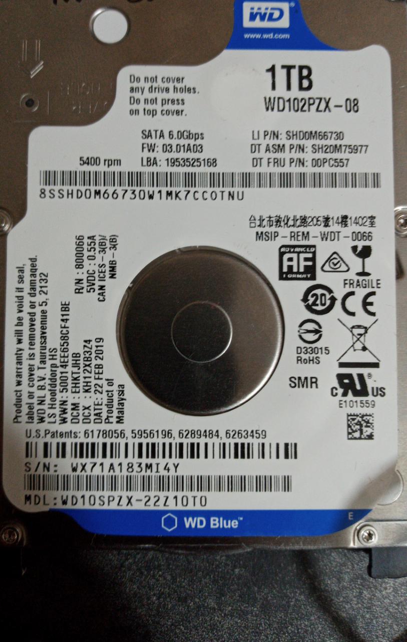

Why not post something meaningful like the actual model number or a picture of the label?
If it has an actual Toshiba PCB, then it's not a WD at all, it's a rebranded Toshiba (though, I've never actually seen that). Are you sure it's not a rebranded HGST?

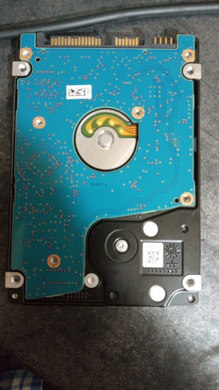

I am so sorry. I thought i already drafted the details..
Its a wd102pzx-08
WD10spzx-22z10t0 written at the bottom

No, I have a HGST that is WD which is having HGST label but WD internally.
This is inverse. WD label but Toshiba inside.

The ROM contains a reference to "TOSHIBA MQ04ABF100".
Is it a fake, or did WD actually rebrand Toshiba HDDs?
The R/N on the label is 800066, so that would be the WD PCB part number. So it looks like a fake.

WD102PZX - top, WD10SPZX - bottom.
Of course fake
 Post subject: Re: WD-2019 MFG with Toshiba like board and SA locked
PostPosted: March 5th, 2020, 7:17
Posts: 4808
i think it is fake. The model number on the label is ambiguous, on the top it says WD102PZX, while you can read WD 10SPZX. The first one looks BS to me, the 2nd one is ok, but it should be a 7mm drive...
Edit: Ah, now i see E123 already spotted that problem...
PostPosted: March 5th, 2020, 7:22
Posts: 3550

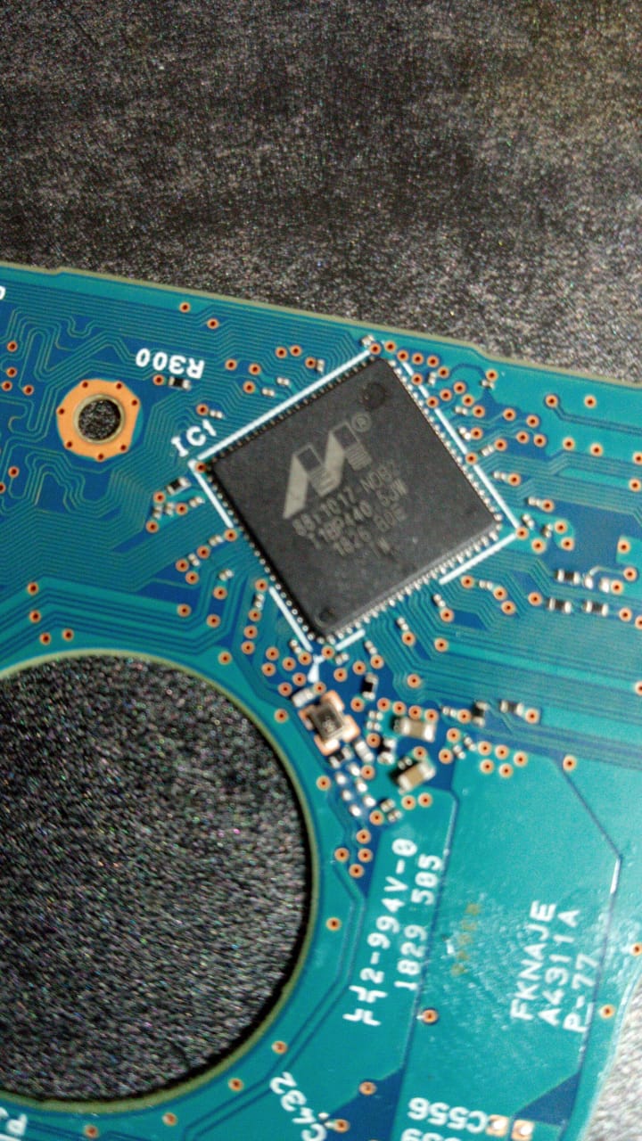

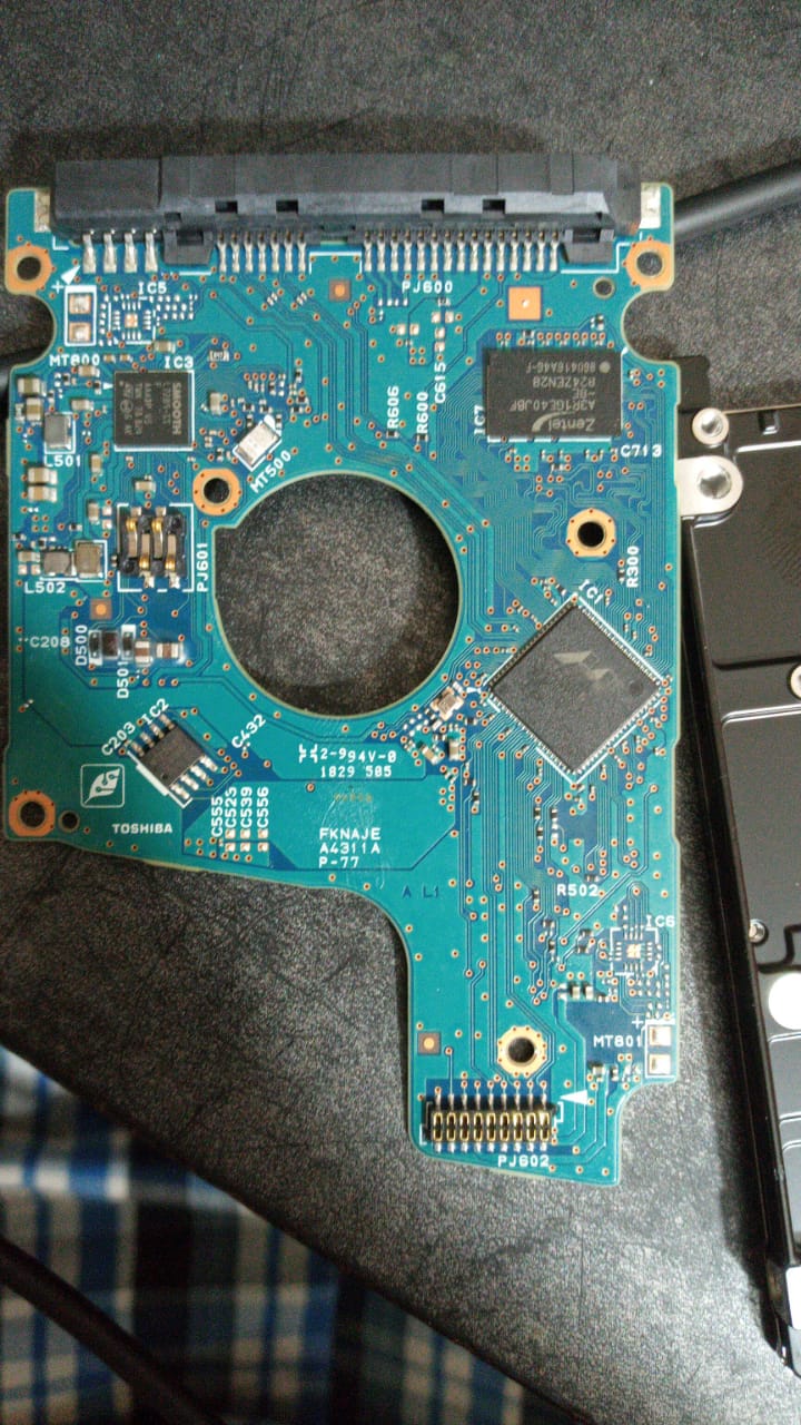

lol, a "Palmer" with a G4311A PCB :lol:
Definitely a fake.

hehehehe....I am convinced aswell, this is fake..However I am waiting for 2 days to see if it reflects warranty. If not, then surely a fake.
The sticker quality, print - the label mistakes, all are so neat.

Another clue that something is wrong is that the date code on the MCU is 1826 (week 26 of 2018) whereas the manufacture date on the label is February 22, 2019. That's a difference of 8 months.
