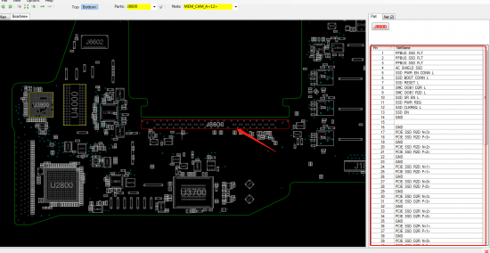

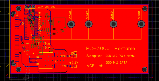

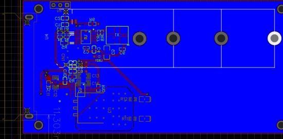

 Post subject: Dolphin adaptor for Apple A1708 SSD
PostPosted: March 31st, 2023, 14:20
Posts: 17226
Does anyone have this adaptor? If so, would they be willing to try a simple, safe, no-cost modification to allow it to support those SSDs with the "big inductor at the top left"?
https://www.dolphindatalab.com/product/macbook-pro-a1708-pcie-ssd-recovery-adapter-smart/
If anyone has the other SSD (small inductors), would they be willing to post photos of the innards?
 Post subject: Re: Dolphin adaptor for Apple A1708 SSD
PostPosted: April 1st, 2023, 17:42
Posts: 17226
I have collated some information on this SSD and the various adaptors:
https://www.hddoracle.com/viewtopic.php?f=106&t=3252
 Post subject: Re: Dolphin adaptor for Apple A1708 SSD
PostPosted: April 4th, 2023, 16:41
Posts: 191
Location: Switzerland
I have it. Let me know how i can help you.
 Post subject: Re: Dolphin adaptor for Apple A1708 SSD
PostPosted: April 4th, 2023, 16:52
Posts: 17226
I contacted Dolphin and asked them if connecting an external 12V supply to pins 1, 2 and 3 of the adaptor would enable it to work with the "big inductor" SSD. They said it wouldn't work. :-(
Ace's adaptor is very clever. It uses pins 1 and 2 of the SATA power connector (these pins are "reserved" or unused) to control the SSD via I2C. When the SSD becomes unresponsive, Ace's Portable can toggle the SSD's hardware reset pin(s). I doubt that Dolphin's adaptor is able to do this, but a look inside the metal can would be very useful. Also, a photo of both sides of the m.2 adaptor would provide a lot of clues, too.
I think Ace's Portable might be able to control other devices via pins 1 and 2. I expect that the unit either has a dedicated I2C host controller, or perhaps Ace bitbangs a couple of GPIO pins to simulate an I2C port.
 Post subject: Re: Dolphin adaptor for Apple A1708 SSD
PostPosted: April 6th, 2023, 11:26
Joined: July 8th, 2019, 12:27
Posts: 162
Location: 中国大陆浙江省湖州市
I contacted Dolphin and asked them if connecting an external 12V supply to pins 1, 2 and 3 of the adaptor would enable it to work with the "big inductor" SSD. They said it wouldn't work. :-(
Ace's adaptor is very clever. It uses pins 1 and 2 of the SATA power connector (these pins are "reserved" or unused) to control the SSD via I2C. When the SSD becomes unresponsive, Ace's Portable can toggle the SSD's hardware reset pin(s). I doubt that Dolphin's adaptor is able to do this, but a look inside the metal can would be very useful. Also, a photo of both sides of the m.2 adaptor would provide a lot of clues, too.
I think Ace's Portable might be able to control other devices via pins 1 and 2. I expect that the unit either has a dedicated I2C host controller, or perhaps Ace bitbangs a couple of GPIO pins to simulate an I2C port.
U1 is the 53rd and 55th pins that NB3N3002DTG connects to the M.2 interface, used as an external clock generator for PCIE host. U2 is TCA9534PWR, an 8-bit expansion chip from Texas Instruments that expands to 16 bits of I/O, used to distinguish whether the hard drive inserted into the interface is using SATA or NVME protocol. Power on/off control is handled by the P3 Portable host. As for determining whether SSDs are frozen, I think it should not be a hardware issue with the converter but rather a status register in either NVME or SATA protocol.
P3_A.png [ 93.26 KiB | Viewed 5992 times ]
P3_nvme.png [ 107.4 KiB | Viewed 5992 times ]
http://flash-matrix.com/
 Post subject: Re: Dolphin adaptor for Apple A1708 SSD
PostPosted: April 6th, 2023, 12:39
Posts: 17226
csava wrote:
U1 is the 53rd and 55th pins that NB3N3002DTG connects to the M.2 interface, used as an external clock generator for PCIE host. U2 is TCA9534PWR, an 8-bit expansion chip from Texas Instruments that expands to 16 bits of I/O, used to distinguish whether the hard drive inserted into the interface is using SATA or NVME protocol. Power on/off control is handled by the P3 Portable host. As for determining whether SSDs are frozen, I think it should not be a hardware issue with the converter but rather a status register in either NVME or SATA protocol.
Thanks, but that's a different adaptor.
 Post subject: Re: Dolphin adaptor for Apple A1708 SSD
PostPosted: April 8th, 2023, 17:29
Posts: 17226
suricate.ch wrote:
I have it. Let me know how i can help you.
Can you show us photos of the m.2 adaptor and a photo of the inside of the metal can?
 Post subject: Re: Dolphin adaptor for Apple A1708 SSD
PostPosted: April 10th, 2023, 1:24
Joined: July 8th, 2019, 12:27
Posts: 162
Location: 中国大陆浙江省湖州市
suricate.ch wrote:
I have it. Let me know how i can help you.
Can you show us photos of the m.2 adaptor and a photo of the inside of the metal can?
make your own adapter :D
SSD.png [ 232.69 KiB | Viewed 5735 times ]
A1780.rar [5.84 MiB]
Downloaded 283 times
http://flash-matrix.com/
 Post subject: Re: Dolphin adaptor for Apple A1708 SSD
PostPosted: April 10th, 2023, 13:01
Posts: 17226
Thanks. I have already collated the same information at my HDD Oracle thread.
