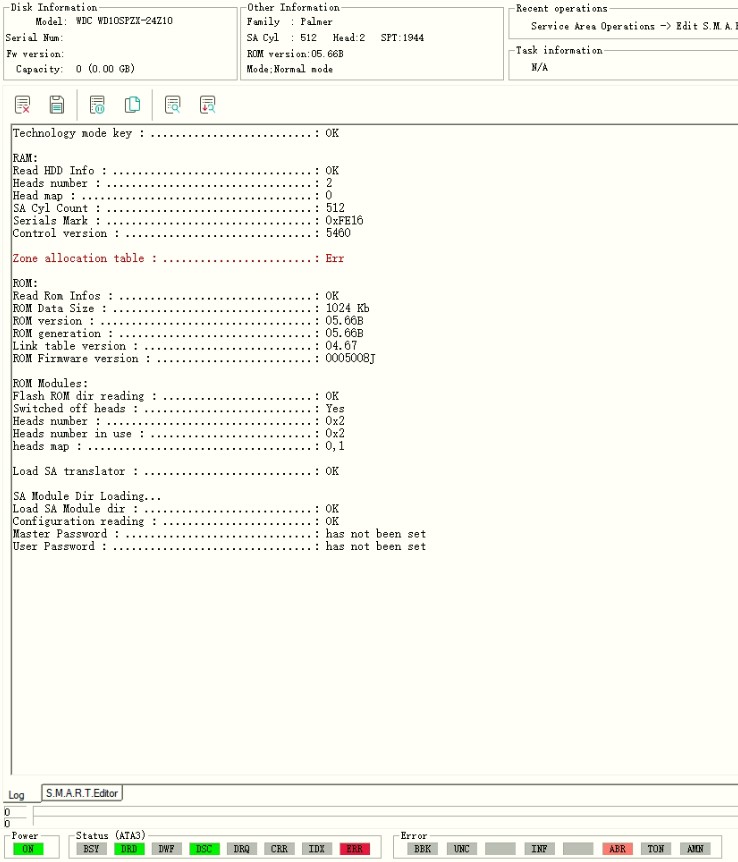

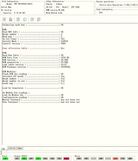

 Post subject: WD ROM Help
PostPosted: October 25th, 2026, 4:08
Joined: April 9th, 2021, 3:47
Posts: 151
Location: Yemen
Could someone help me repair this ROM please ?
ROM.rar [639.48 KiB]
Downloaded 17 times
WhatsApp Image 2026-10-25 at 4.04.19 PM.jpeg
WhatsApp Image 2026-10-25 at 4.04.19 PM.jpeg [ 218.58 KiB | Viewed 614 times ]
 Post subject: Re: WD ROM Help
PostPosted: October 25th, 2026, 4:50
Joined: May 30th, 2005, 17:07
Posts: 548
Why do you think there is an issue with the ROM?
Mikippp
 Post subject: Re: WD ROM Help
PostPosted: October 25th, 2026, 5:35
Posts: 845
Location: Pakistan
a donor ROM can also be used if you know certain information about the original ROM.
but again as Mikippp said why you think there is a problem with the ROM.. what is behavior of drive with original ROM ?
Data Recovery Pakistan
 Post subject: Re: WD ROM Help
PostPosted: October 25th, 2026, 6:04
Joined: April 9th, 2021, 3:47
Posts: 151
Location: Yemen
Mikippp wrote:
Why do you think there is an issue with the ROM?
Mikippp
After unlock it and reflash it to the chip it give no sign of life
 Post subject: Re: WD ROM Help
PostPosted: October 25th, 2026, 6:08
Joined: April 9th, 2021, 3:47
Posts: 151
Location: Yemen
MindMergepk wrote:
a donor ROM can also be used if you know certain information about the original ROM.
but again as Mikippp said why you think there is a problem with the ROM.. what is behavior of drive with original ROM ?
When i turn on the hdd it only gives the model number
 Post subject: Re: WD ROM Help
PostPosted: October 25th, 2026, 8:22
Joined: April 9th, 2021, 3:47
Posts: 151
Location: Yemen
now i have this issue
1.jpg [ 113.67 KiB | Viewed 517 times ]
 Post subject: Re: WD ROM Help
PostPosted: October 25th, 2026, 8:40
Posts: 17316
It appears that the drive is identifying itself with the information in the ROM:
Analysing active 0x0D module ...
Firmware Version = 05.01A05
World Wide Name = 50014EE213686C7E
Model Number = WDC WD10SPZX-24Z10
Serial Number =
That suggests that it cannot read, or make sense of, module 0x02.
Are you able to upload 0x02?
 Post subject: Re: WD ROM Help
PostPosted: October 25th, 2026, 9:04
Joined: April 9th, 2021, 3:47
Posts: 151
Location: Yemen
It appears that the drive is identifying itself with the information in the ROM:
Analysing active 0x0D module ...
Firmware Version = 05.01A05
World Wide Name = 50014EE213686C7E
Model Number = WDC WD10SPZX-24Z10
Serial Number =
That suggests that it cannot read, or make sense of, module 0x02.
Are you able to upload 0x02?
this one ?
02_ByID.rar [1.6 KiB]
Downloaded 15 times
 Post subject: Re: WD ROM Help
PostPosted: October 25th, 2026, 9:11
Posts: 17316
That looks OK. The model number is longer -- WD10SPZX-24Z10T1 (SA module 02) versus WD10SPZX-24Z10 (ROM module 0D).
 Post subject: Re: WD ROM Help
PostPosted: October 25th, 2026, 9:36
Joined: April 9th, 2021, 3:47
Posts: 151
Location: Yemen
That looks OK. The model number is longer -- WD10SPZX-24Z10T1 (SA module 02) versus WD10SPZX-24Z10 (ROM module 0D).
yes
what should i do now ?
 Post subject: Re: WD ROM Help
PostPosted: October 25th, 2026, 10:10
Posts: 17316
I have no idea. Yours peers would know better than me.
 Post subject: Re: WD ROM Help
PostPosted: Yesterday, 4:56
Posts: 845
Location: Pakistan
Core.iStores wrote:
Mikippp wrote:
Why do you think there is an issue with the ROM?
Mikippp
After unlock it and reflash it to the chip it give no sign of life
was drive give full ID before unlocking the ROM? or this is the same behavior both with lock and unlock rom?
As per ROM WWN: 50014EE213686C7E07 you can cross check it with sticker if ROM is native.
from screen drive does have SA access, so problem could be with some SA module.. test the SA (all modules) to find out where is the problem ?
Data Recovery Pakistan
 Post subject: Re: WD ROM Help
PostPosted: Yesterday, 22:13
Joined: April 9th, 2021, 3:47
Posts: 151
Location: Yemen
MindMergepk wrote:
Core.iStores wrote:
Mikippp wrote:
Why do you think there is an issue with the ROM?
Mikippp
After unlock it and reflash it to the chip it give no sign of life
was drive give full ID before unlocking the ROM? or this is the same behavior both with lock and unlock rom?
As per ROM WWN: 50014EE213686C7E07 you can cross check it with sticker if ROM is native.
from screen drive does have SA access, so problem could be with some SA module.. test the SA (all modules) to find out where is the problem ?
i checked the ROM and at the Serial Number is also empty
ROManalysis.txt [5.99 KiB]
Downloaded 6 times
 Post subject: Re: WD ROM Help
PostPosted: Today, 0:59
Posts: 4841
rom looks native.
After unlock it and reflash it to the chip it give no sign of life
what do you call a sign of life?
does it spin up? did it spin up before unlocking?
If it spins, does it move heads? If not, problem is likely heads.
Since you get at least something in ID i would not call it 'no sign of life'.
 Post subject: Re: WD ROM Help
PostPosted: 51 minutes ago
Joined: April 9th, 2021, 3:47
Posts: 151
Location: Yemen
pepe wrote:
rom looks native.
After unlock it and reflash it to the chip it give no sign of life
what do you call a sign of life?
does it spin up? did it spin up before unlocking?
If it spins, does it move heads? If not, problem is likely heads.
Since you get at least something in ID i would not call it 'no sign of life'.
After doing some attempts the ROM worked but it gives this results that shows in the attached photo
I managed to read some modules by ID and reading by Track or ABA it couldn’t read at all, it’s gives error
IMG_3120.jpeg [ 120.04 KiB | Viewed 17 times ]
