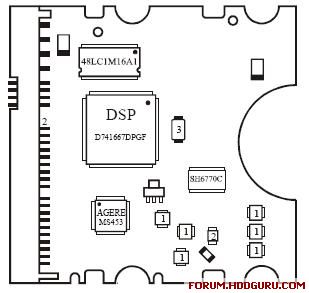

 Post subject: 4D clicking
PostPosted: April 10th, 2007, 15:58
Posts: 2288
Location: In ur HDD !
I have a problem with a PCB of 4d040h2 when i plug that pcb to any drive it starts clicking and after i remove that pcb and plug a completly functional one
it start working fine . I want to know what could be the problem with the PCB .
Below i am attaching a picture of a 4d040h2 pcb please tell me which componenet could cause such a problem . So i can replace it .
Thanks in advance .
 Post subject:
PostPosted: April 10th, 2007, 23:21
Joined: September 16th, 2006, 8:51
Posts: 141
Location: Vietnam
Did you try to replace of IC SH6770C, that is the power cotrol?
 Post subject:
PostPosted: April 11th, 2007, 16:18
Posts: 2288
Location: In ur HDD !
i will try it thanks . Could there be problem in the Agere m5453 thats the spindle controller chip ?
correct me if i am wrong.
thanks
 Post subject:
PostPosted: April 12th, 2007, 11:41
Posts: 4826
U are wrong :)
the agere IC is the reading/writing channel.
U should check the -5V power line if the drive is clicking with only this PCB.
I think somebody in DR businnes should have at least basic electronic education to recognize the parts, engineer level is recommended...
regards,
 Post subject:
PostPosted: April 12th, 2007, 14:05
Posts: 2288
Location: In ur HDD !
thanku for ur reply if there is problem with the 5V power line then i should chek the DC-DC convertor .
 Post subject:
PostPosted: April 12th, 2007, 14:52
Posts: 4826
:idea:
 Post subject:
PostPosted: April 12th, 2007, 15:53
Posts: 2288
Location: In ur HDD !
What?
 Post subject:
PostPosted: April 13th, 2007, 15:09
Posts: 4826
I mean yes, check the converter wether it produces a stable -5V for the preamp!
regards,
 Post subject:
PostPosted: May 6th, 2007, 15:03
Joined: April 27th, 2007, 4:07
Posts: 32
normally from this IC SH6770C hdd click specially 4d0 .
PLS check from other pcb number B9FDA or B9FDB
firmware cod : DAHO17K0
Users browsing this forum: Google [Bot], Jonny_Quick and 262 guests
