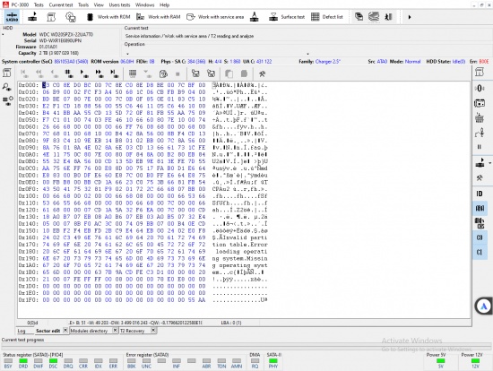

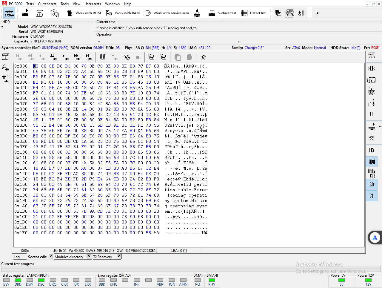

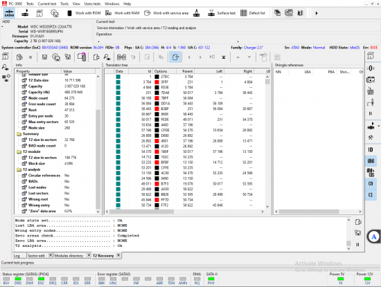

Hello everyone,
I tried to recover 2.5 western digital Drive, Model number WD20SPZX, When I try to access the files in DE, there is no user data available. I perform T2 recovery and backup modules and SA, The sectors look good on sector edit, also module 01A Error occurred. Could you please advise.
Thanks.

If sectors look ok, what is the problem for which you need advice?
 Post subject: Re: Western Digital does not access user data
PostPosted: June 20th, 2024, 8:44
Posts: 163
The drive was blocked from access to SA by default?
Can you post a screenshot of the T2 reading?
How many percent does the tool say is filled with zeros after T2 reading?

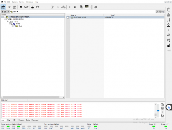

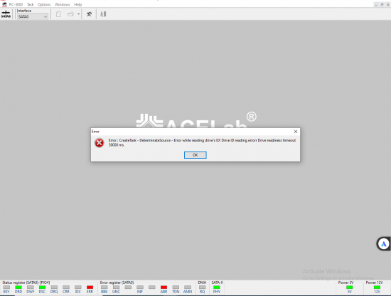

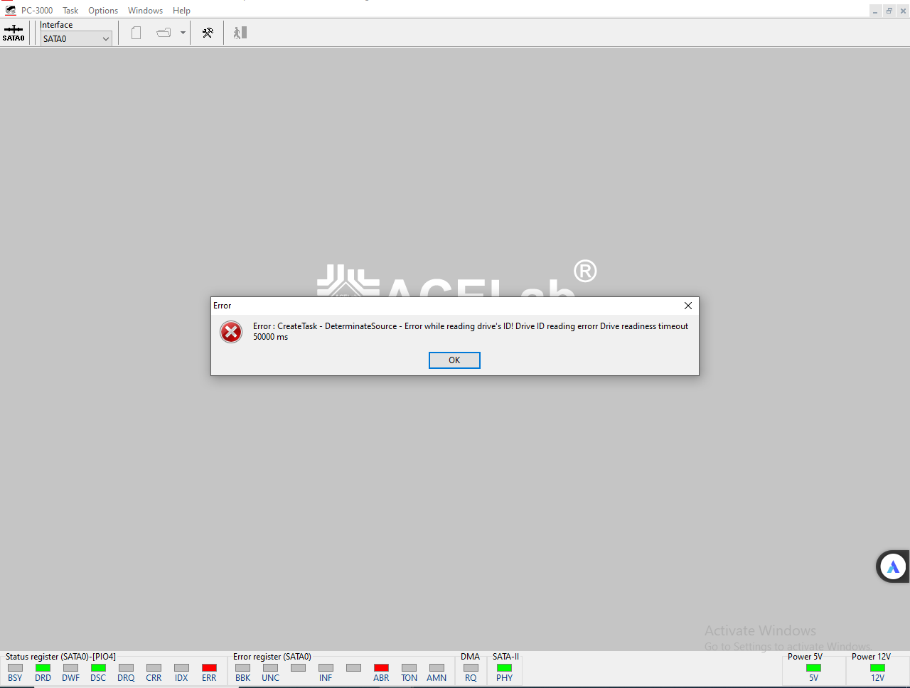

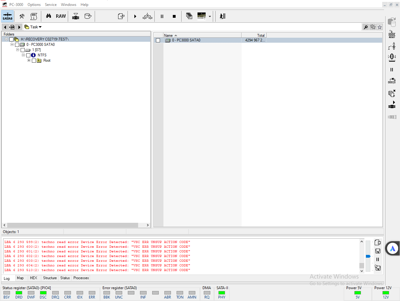

Hi pepe, appreciate the response. The problem is I'm getting an error entering DE and no access to client's data. I have attached the screen shots of the errors. Sectors are read using utility.
File comment: Read using utility. whole sectors are read fully
File comment: DE entered without drive ID
File comment: Trying to enter DE with Drive ID checked

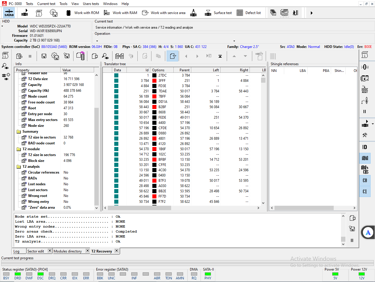

The heads seem to write ok.
PostPosted: June 21st, 2024, 3:11
Posts: 4809
VSC_UNSUP_ACTION_CODE occurs when ovl is not loaded, so i suppose the drive restarted coz of some error and stayed without ovl. what does status sector say?

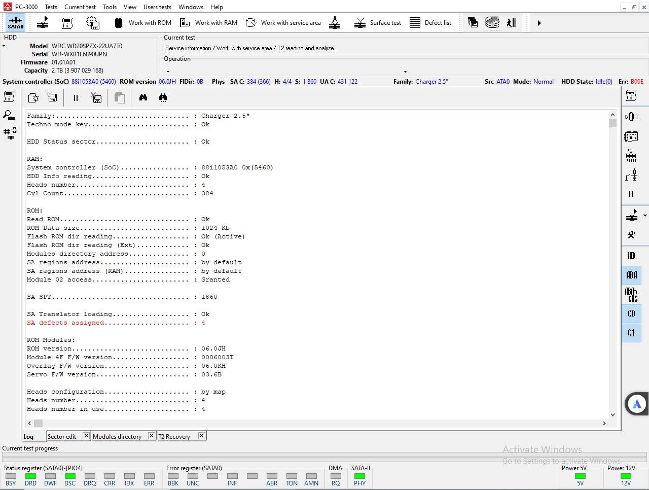

Please forgive my ignorance but do you mean this?

Joined: May 30th, 2005, 17:07
Posts: 546

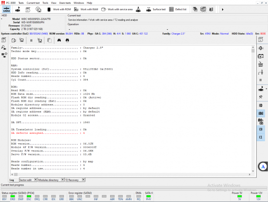

Tools -> Utility extensions -> HDD State
Mikippp
Thank you Mikippp :mrgreen:
PostPosted: June 26th, 2024, 2:22
Joined: March 4th, 2015, 8:52
Posts: 69
Location: Ethiopia
Here is the HDD state
HDD Info.docx [22.78 KiB]
Downloaded 248 times
State Sector.docx [26 KiB]
Downloaded 247 times
